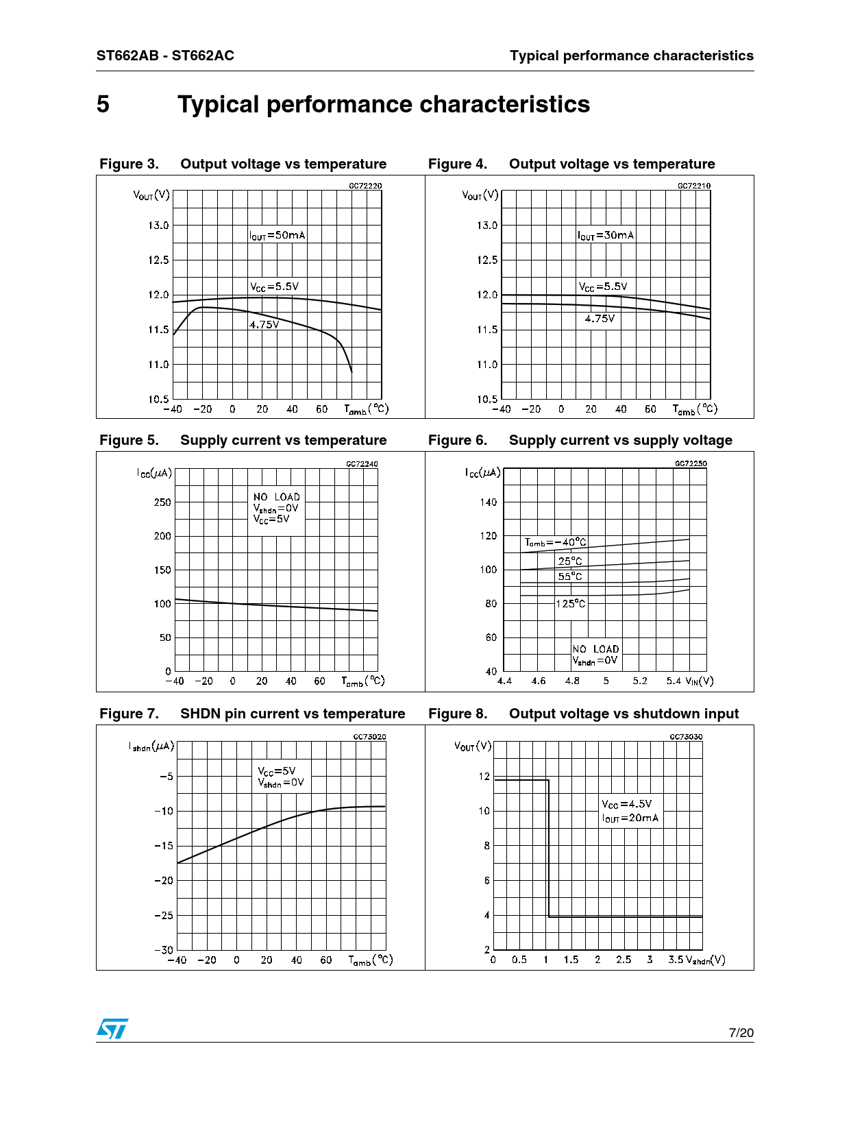

ST662AB - ST662AC. Typical performance characteristics. Figure 3. Output voltage vs temperature. Figure 4. Figure 5
ST662AB - ST662AC Typical performance characteristics Figure 3 Output voltage vs temperature Figure 4 Figure 5
ST662AB - ST662AC Typical performance characteristics 5 Typical performance characteristics Figure 3. Output voltage vs temperature Figure 4. Output voltage vs temperature Figure 5. Supply current vs temperature Figure 6. Supply current vs supply voltage Figure 7. SHDN pin current vs temperature Figure 8. Output voltage vs shutdown input
7/20 Document Outline Table 1. Device summary 1 Application circuit Figure 1. Typical application circuit 2 Pin configuration Figure 2. Pin connections (top view) Table 2. Pin description 3 Maximum ratings Table 3. Absolute maximum ratings Table 4. Thermal data 4 Electrical characteristics Table 5. Electrical characteristics (Refer to the test circuits, VCC = 4.5V to 5.5V, TA = TMIN to TMAX, unless otherwise specified. Typical value are referred at TA = 25˚C) 5 Typical performance characteristics Figure 3. Output voltage vs temperature Figure 4. Output voltage vs temperature Figure 5. Supply current vs temperature Figure 6. Supply current vs supply voltage Figure 7. SHDN pin current vs temperature Figure 8. Output voltage vs shutdown input Figure 9. Output voltage vs shutdown input voltage Figure 10. Output voltage vs shutdown input voltage Figure 11. Test circuit 6 Description Figure 12. Operating principle circuit Figure 13. Exiting shutdown Figure 14. Entering shutdown 7 Application circuit Figure 15. KIT Lay-out Figure 16. Electrical schematic Table 6. List of component 7.1 ST662A output performance Figure 17. Output voltage vs output current Figure 18. Efficiency vs output current Figure 19. Load transient response Figure 20. Load transient response 8 How to increase output current or output voltage capability Figure 21. Application circuit for two ST662A in parallel Table 7. List of component Figure 22. Application circuit for output voltage greater than 12V Figure 23. Output voltage for the application with two device in parallel Figure 24. Output voltage for application with output voltage greater than 12V 9 Package mechanical data 10 Revision history Table 8. Revision history
