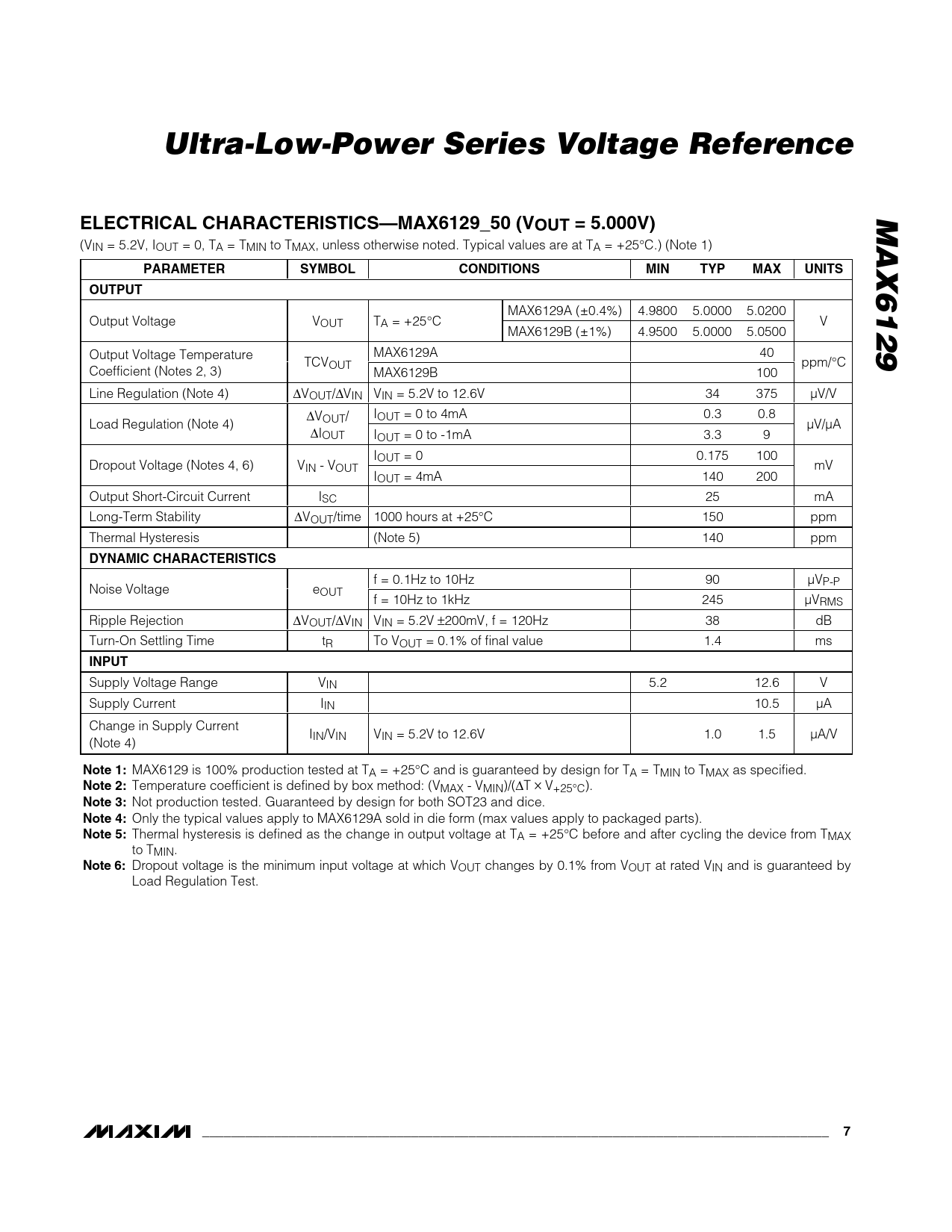

Ultra-Low-Power Series Voltage Reference. MAX6129. ELECTRICAL CHARACTERISTICS—MAX6129_50 (VOUT = 5.000V). PARAMETER. SYMBOL
Ultra-Low-Power Series Voltage Reference MAX6129 ELECTRICAL CHARACTERISTICS—MAX6129_50 (VOUT = 5.000V) PARAMETER SYMBOL
(VIN = 5.2V, IOUT = 0, TA = TMIN to TMAX, unless otherwise noted. Typical values are at TA = +25°C.) (Note 1)
PARAMETER SYMBOL CONDITIONS MIN TYP MAX UNITS OUTPUT
MAX6129A (±0.4%) 4.9800 5.0000 5.0200 Output Voltage VOUT TA = +25°C V MAX6129B (±1%) 4.9500 5.0000 5.0500 Output Voltage Temperature MAX6129A 40 TCVOUT ppm/°C Coefficient (Notes 2, 3) MAX6129B 100 Line Regulation (Note 4) ∆VOUT/∆VIN VIN = 5.2V to 12.6V 34 375 µV/V I ∆V OUT = 0 to 4mA 0.3 0.8 Load Regulation (Note 4) OUT/ ∆ µV/µA IOUT IOUT = 0 to -1mA 3.3 9 IOUT = 0 0.175 100 Dropout Voltage (Notes 4, 6) VIN - VOUT mV IOUT = 4mA 140 200 Output Short-Circuit Current ISC 25 mA Long-Term Stability ∆VOUT/time 1000 hours at +25°C 150 ppm Thermal Hysteresis (Note 5) 140 ppm
DYNAMIC CHARACTERISTICS
f = 0.1Hz to 10Hz 90 µVP-P Noise Voltage eOUT f = 10Hz to 1kHz 245 µVRMS Ripple Rejection ∆VOUT/∆VIN VIN = 5.2V ±200mV, f = 120Hz 38 dB Turn-On Settling Time tR To VOUT = 0.1% of final value 1.4 ms
INPUT
Supply Voltage Range VIN 5.2 12.6 V Supply Current IIN 10.5 µA Change in Supply Current IIN/VIN VIN = 5.2V to 12.6V 1.0 1.5 µA/V (Note 4)
Note 1:
MAX6129 is 100% production tested at TA = +25°C and is guaranteed by design for TA = TMIN to TMAX as specified.
Note 2:
Temperature coefficient is defined by box method: (VMAX - VMIN)/(∆T ✕ V+25°C).
Note 3:
Not production tested. Guaranteed by design for both SOT23 and dice.
Note 4:
Only the typical values apply to MAX6129A sold in die form (max values apply to packaged parts).
Note 5:
Thermal hysteresis is defined as the change in output voltage at TA = +25°C before and after cycling the device from TMAX to TMIN.
Note 6:
Dropout voltage is the minimum input voltage at which VOUT changes by 0.1% from VOUT at rated VIN and is guaranteed by Load Regulation Test.
