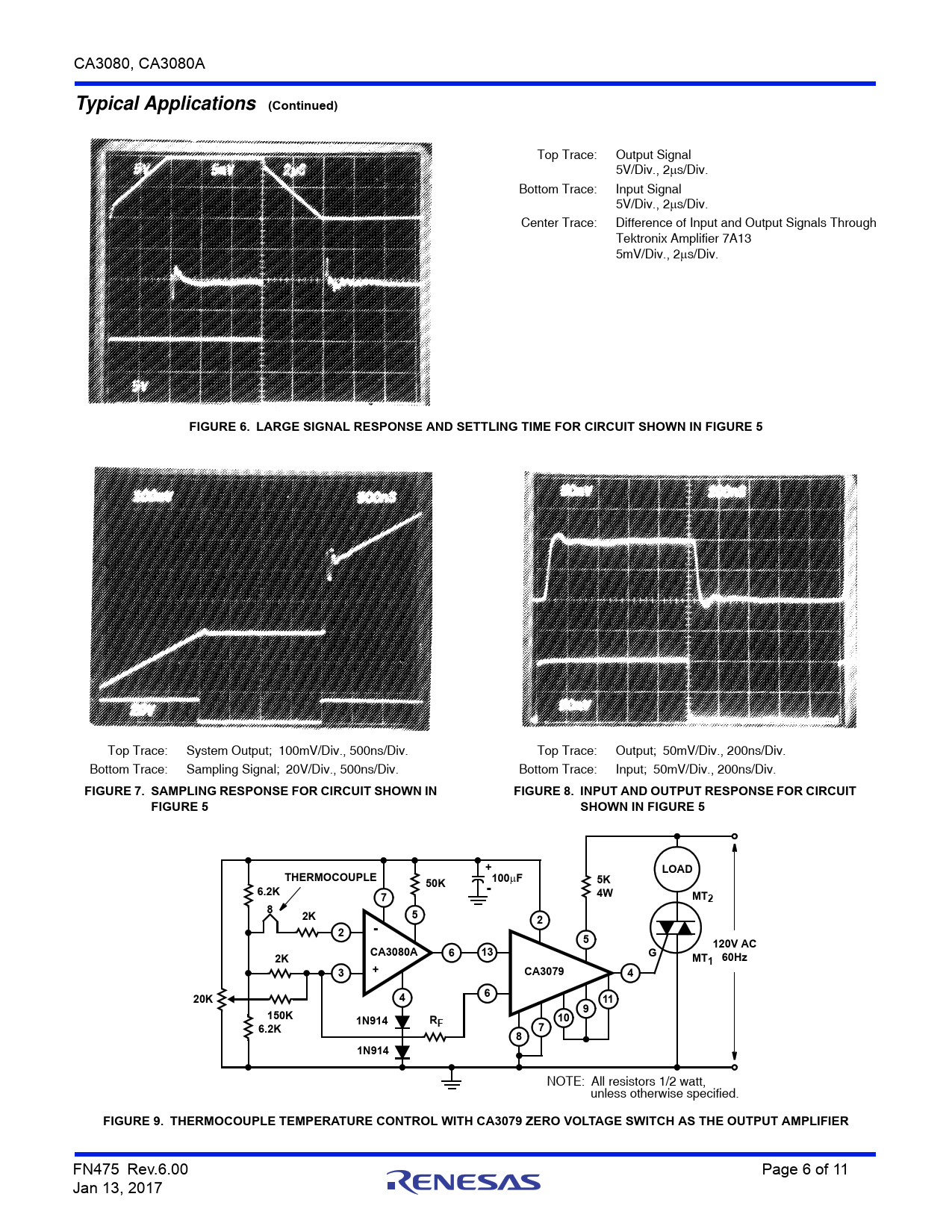

Typical Applications. (Continued). FIGURE 6. LARGE SIGNAL RESPONSE AND SETTLING TIME FOR CIRCUIT SHOWN IN FIGURE 5
Typical Applications (Continued) FIGURE 6 LARGE SIGNAL RESPONSE AND SETTLING TIME FOR CIRCUIT SHOWN IN FIGURE 5
CA3080, CA3080A
Top Trace: Output Signal 5V/Div., 2s/Div. Bottom Trace: Input Signal 5V/Div., 2s/Div. Center Trace: Difference of Input and Output Signals Through Tektronix Amplifier 7A13 5mV/Div., 2s/Div.
Top Trace: System Output; 100mV/Div., 500ns/Div. Top Trace: Output; 50mV/Div., 200ns/Div. Bottom Trace: Sampling Signal; 20V/Div., 500ns/Div. Bottom Trace: Input; 50mV/Div., 200ns/Div.
FIGURE 7. SAMPLING RESPONSE FOR CIRCUIT SHOWN IN FIGURE 8. INPUT AND OUTPUT RESPONSE FOR CIRCUIT FIGURE 5 SHOWN IN FIGURE 5 + LOAD THERMOCOUPLE 100
F 5K 50K 6.2K - 7 4W MT2 8 2K 5 2 2 - 5 120V AC CA3080A 6 13 G 2K MT 60Hz 1 3 + CA3079 4 20K 4 6 11 9 150K 10 1N914 R 6.2K F 7 8 1N914
NOTE: All resistors 1/2 watt, unless otherwise specified.
FIGURE 9. THERMOCOUPLE TEMPERATURE CONTROL WITH CA3079 ZERO VOLTAGE SWITCH AS THE OUTPUT AMPLIFIER
