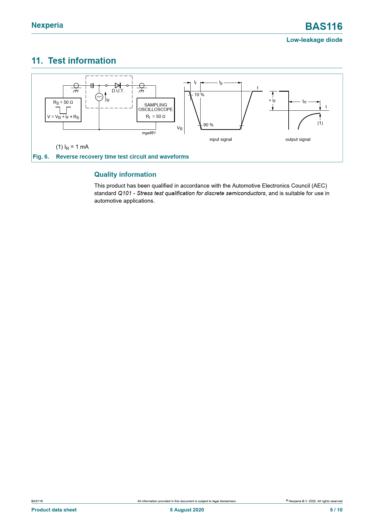

Nexperia. BAS116. Low-leakage diode. 11. Test information. Fig. 6. Reverse recovery time test circuit and waveforms
Nexperia BAS116 Low-leakage diode 11 Test information Fig 6 Reverse recovery time test circuit and waveforms
Nexperia BAS116 Low-leakage diode 11. Test information
tr tp t D.U.T. 10 % + I R F trr S = 50 Ω IF SAMPLING t OSCILLOSCOPE V = VR + IF × RS Ri = 50 Ω (1) 90 % VR mga881 input signal output signal (1) IR = 1 mA
Fig. 6. Reverse recovery time test circuit and waveforms Quality information
This product has been qualified in accordance with the Automotive Electronics Council (AEC) standard Q101 - Stress test qualification for discrete semiconductors, and is suitable for use in automotive applications. BAS116 All information provided in this document is subject to legal disclaimers. © Nexperia B.V. 2020. Al rights reserved
