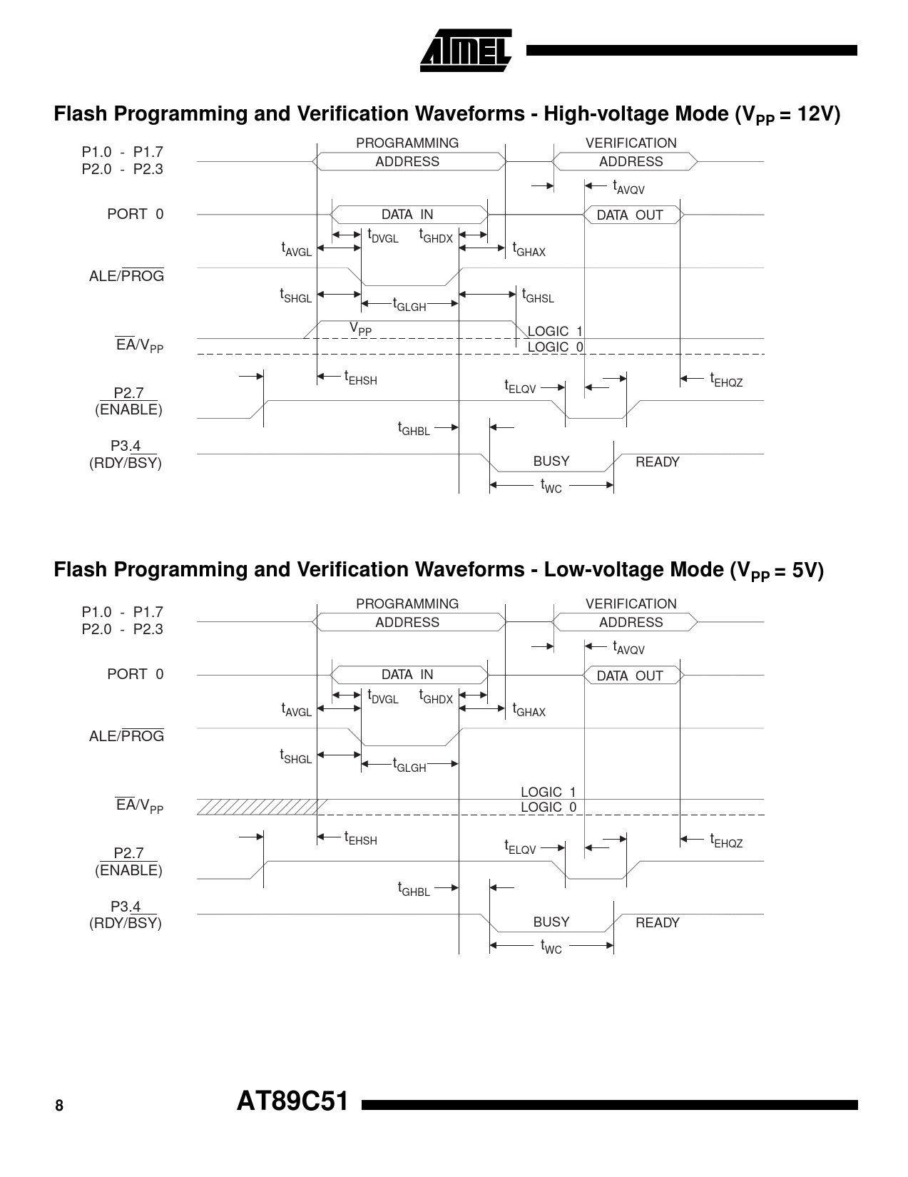

Flash Programming and Verification Waveforms - High-voltage Mode (V. = 12V)
Flash Programming and Verification Waveforms - High-voltage Mode (V = 12V)
Flash Programming and Verification Waveforms - High-voltage Mode (V = 12V) PP
PROGRAMMING VERIFICATION P1.0 - P1.7 ADDRESS ADDRESS P2.0 - P2.3 tAVQV PORT 0 DATA IN DATA OUT t t DVGL GHDX t t AVGL GHAX ALE/PROG t t SHGL t GHSL GLGH VPP LOGIC 1 EA/VPP LOGIC 0 tEHSH t tEHQZ ELQV P2.7 (ENABLE) tGHBL P3.4 (RDY/BSY) BUSY READY tWC
Flash Programming and Verification Waveforms - Low-voltage Mode (V = 5V) PP
PROGRAMMING VERIFICATION P1.0 - P1.7 ADDRESS ADDRESS P2.0 - P2.3 tAVQV PORT 0 DATA IN DATA OUT t t DVGL GHDX t t AVGL GHAX ALE/PROG tSHGL tGLGH LOGIC 1 EA/VPP LOGIC 0 tEHSH t tEHQZ ELQV P2.7 (ENABLE) tGHBL P3.4 (RDY/BSY) BUSY READY tWC
