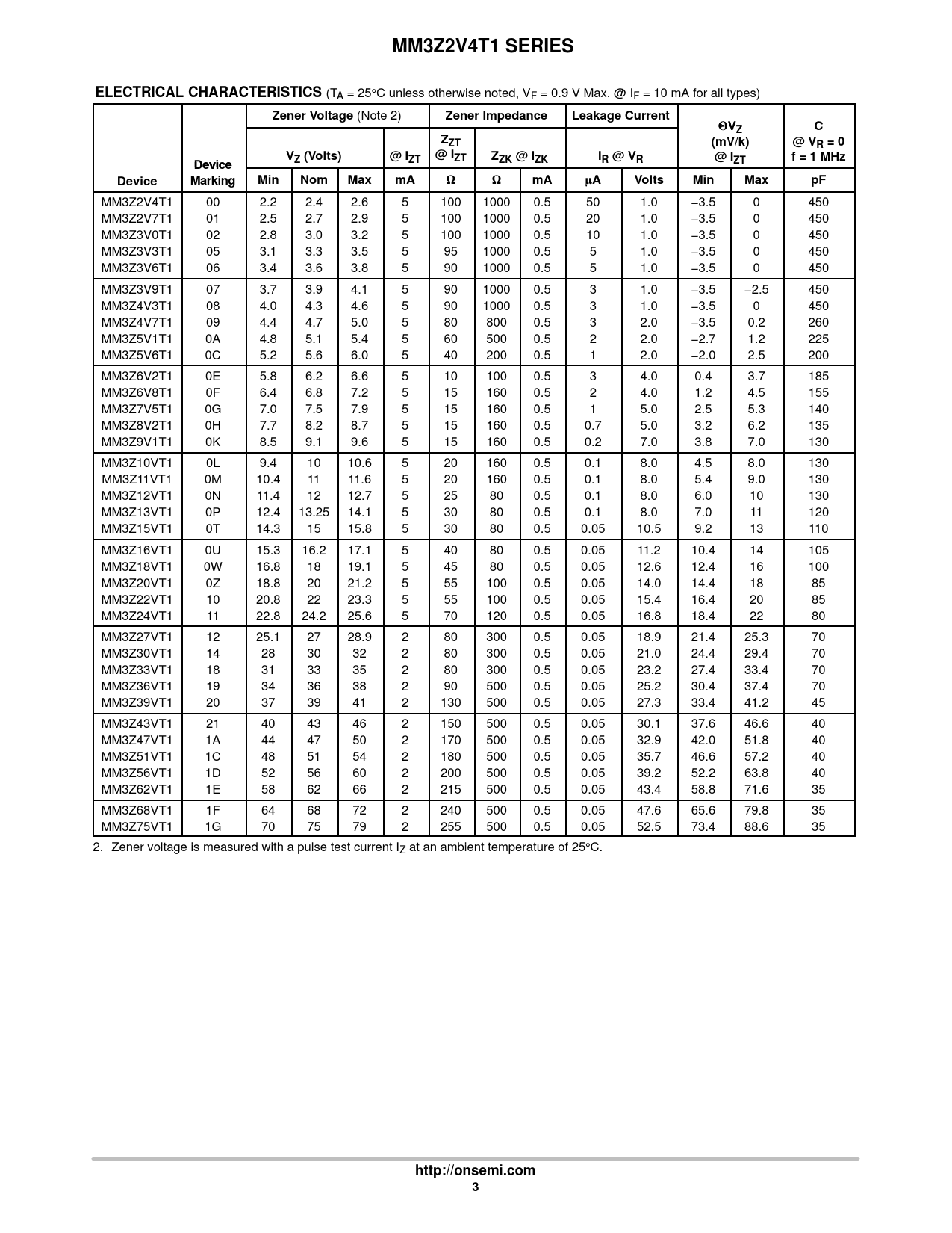

DescriptionZener Voltage Regulators 200 mW SOD−323 Surface Mount
Pages / Page6 / 3 — MM3Z2V4T1 SERIES. ELECTRICAL CHARACTERISTICS. Zener Voltage. Zener …
File Format / SizePDF / 62 Kb
MM3Z2V4T1 SERIES. ELECTRICAL CHARACTERISTICS. Zener Voltage. Zener Impedance. Leakage Current. ZZT. (mV/k). @ VR = 0. @ IZT. @ I. f = 1 MHz
MM3Z2V4T1 SERIES ELECTRICAL CHARACTERISTICS Zener Voltage Zener Impedance Leakage Current ZZT (mV/k) @ VR = 0 @ IZT @ I f = 1 MHz
(TA = 25°C unless otherwise noted, VF = 0.9 V Max. @ IF = 10 mA for all types)
Zener Voltage
(Note 2)
Zener Impedance Leakage Current V Z V C Z ZZT (mV/k) @ VR = 0 V @ IZT Z @ I f = 1 MHz Device Z (Volts) @ IZT ZK @ IZK IR @ VR ZT Device Device Marking Min Nom Max mA mA A Volts Min Max pF
MM3Z2V4T1 00 2.2 2.4 2.6 5 100 1000 0.5 50 1.0 −3.5 0 450 MM3Z2V7T1 01 2.5 2.7 2.9 5 100 1000 0.5 20 1.0 −3.5 0 450 MM3Z3V0T1 02 2.8 3.0 3.2 5 100 1000 0.5 10 1.0 −3.5 0 450 MM3Z3V3T1 05 3.1 3.3 3.5 5 95 1000 0.5 5 1.0 −3.5 0 450 MM3Z3V6T1 06 3.4 3.6 3.8 5 90 1000 0.5 5 1.0 −3.5 0 450 MM3Z3V9T1 07 3.7 3.9 4.1 5 90 1000 0.5 3 1.0 −3.5 −2.5 450 MM3Z4V3T1 08 4.0 4.3 4.6 5 90 1000 0.5 3 1.0 −3.5 0 450 MM3Z4V7T1 09 4.4 4.7 5.0 5 80 800 0.5 3 2.0 −3.5 0.2 260 MM3Z5V1T1 0A 4.8 5.1 5.4 5 60 500 0.5 2 2.0 −2.7 1.2 225 MM3Z5V6T1 0C 5.2 5.6 6.0 5 40 200 0.5 1 2.0 −2.0 2.5 200 MM3Z6V2T1 0E 5.8 6.2 6.6 5 10 100 0.5 3 4.0 0.4 3.7 185 MM3Z6V8T1 0F 6.4 6.8 7.2 5 15 160 0.5 2 4.0 1.2 4.5 155 MM3Z7V5T1 0G 7.0 7.5 7.9 5 15 160 0.5 1 5.0 2.5 5.3 140 MM3Z8V2T1 0H 7.7 8.2 8.7 5 15 160 0.5 0.7 5.0 3.2 6.2 135 MM3Z9V1T1 0K 8.5 9.1 9.6 5 15 160 0.5 0.2 7.0 3.8 7.0 130 MM3Z10VT1 0L 9.4 10 10.6 5 20 160 0.5 0.1 8.0 4.5 8.0 130 MM3Z11VT1 0M 10.4 11 11.6 5 20 160 0.5 0.1 8.0 5.4 9.0 130 MM3Z12VT1 0N 11.4 12 12.7 5 25 80 0.5 0.1 8.0 6.0 10 130 MM3Z13VT1 0P 12.4 13.25 14.1 5 30 80 0.5 0.1 8.0 7.0 11 120 MM3Z15VT1 0T 14.3 15 15.8 5 30 80 0.5 0.05 10.5 9.2 13 110 MM3Z16VT1 0U 15.3 16.2 17.1 5 40 80 0.5 0.05 11.2 10.4 14 105 MM3Z18VT1 0W 16.8 18 19.1 5 45 80 0.5 0.05 12.6 12.4 16 100 MM3Z20VT1 0Z 18.8 20 21.2 5 55 100 0.5 0.05 14.0 14.4 18 85 MM3Z22VT1 10 20.8 22 23.3 5 55 100 0.5 0.05 15.4 16.4 20 85 MM3Z24VT1 11 22.8 24.2 25.6 5 70 120 0.5 0.05 16.8 18.4 22 80 MM3Z27VT1 12 25.1 27 28.9 2 80 300 0.5 0.05 18.9 21.4 25.3 70 MM3Z30VT1 14 28 30 32 2 80 300 0.5 0.05 21.0 24.4 29.4 70 MM3Z33VT1 18 31 33 35 2 80 300 0.5 0.05 23.2 27.4 33.4 70 MM3Z36VT1 19 34 36 38 2 90 500 0.5 0.05 25.2 30.4 37.4 70 MM3Z39VT1 20 37 39 41 2 130 500 0.5 0.05 27.3 33.4 41.2 45 MM3Z43VT1 21 40 43 46 2 150 500 0.5 0.05 30.1 37.6 46.6 40 MM3Z47VT1 1A 44 47 50 2 170 500 0.5 0.05 32.9 42.0 51.8 40 MM3Z51VT1 1C 48 51 54 2 180 500 0.5 0.05 35.7 46.6 57.2 40 MM3Z56VT1 1D 52 56 60 2 200 500 0.5 0.05 39.2 52.2 63.8 40 MM3Z62VT1 1E 58 62 66 2 215 500 0.5 0.05 43.4 58.8 71.6 35 MM3Z68VT1 1F 64 68 72 2 240 500 0.5 0.05 47.6 65.6 79.8 35 MM3Z75VT1 1G 70 75 79 2 255 500 0.5 0.05 52.5 73.4 88.6 35 2. Zener voltage is measured with a pulse test current IZ at an ambient temperature of 25°C.
