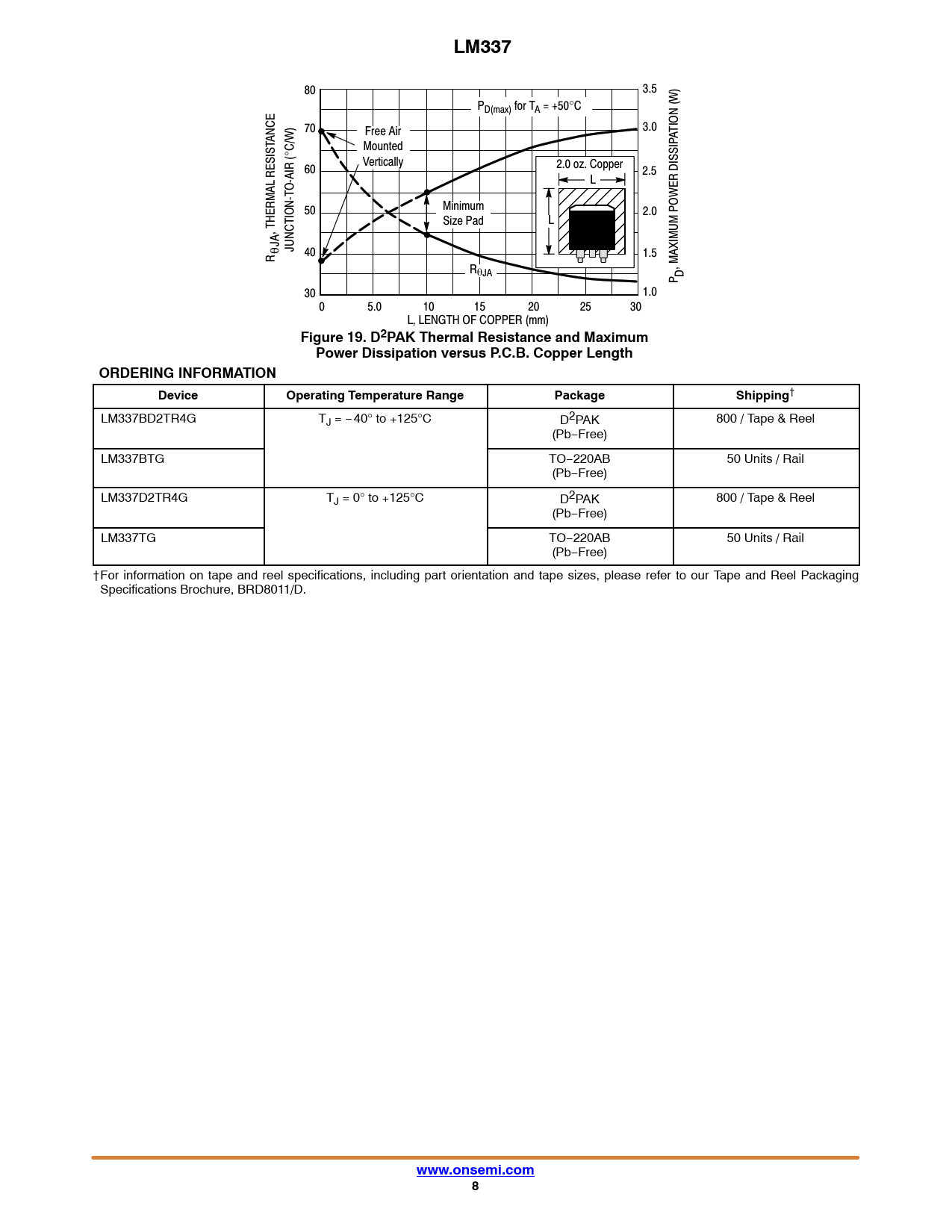

LM337. Figure 19. D2PAK Thermal Resistance and Maximum. Power Dissipation versus P.C.B. Copper Length. ORDERING INFORMATION
LM337 Figure 19 D2PAK Thermal Resistance and Maximum Power Dissipation versus P.C.B Copper Length ORDERING INFORMATION
LM337
80 3.5 PD(max) for TA = +50°C 70 3.0 TION (W) Free Air ANCE A ° Mounted Vertically 60 2.0 oz. Copper RESIST 2.5 L O‐AIR ( C/W) ÎÎÎÎ 50 Minimum 2.0 ÎÎÎÎ Size Pad L , THERMAL JA ÎÎÎÎ θ JUNCTION‐T 40 R 1.5 ÎÎÎÎ , MAXIMUM POWER DISSIP RqJA D P 30 1.0 0 5.0 10 15 20 25 30 L, LENGTH OF COPPER (mm)
Figure 19. D2PAK Thermal Resistance and Maximum Power Dissipation versus P.C.B. Copper Length ORDERING INFORMATION Device Operating Temperature Range Package Shipping
† LM337BD2TR4G TJ = −40° to +125°C D2PAK 800 / Tape & Reel (Pb−Free) LM337BTG TO−220AB 50 Units / Rail (Pb−Free) LM337D2TR4G TJ = 0° to +125°C D2PAK 800 / Tape & Reel (Pb−Free) LM337TG TO−220AB 50 Units / Rail (Pb−Free) †For information on tape and reel specifications, including part orientation and tape sizes, please refer to our Tape and Reel Packaging Specifications Brochure, BRD8011/D.
