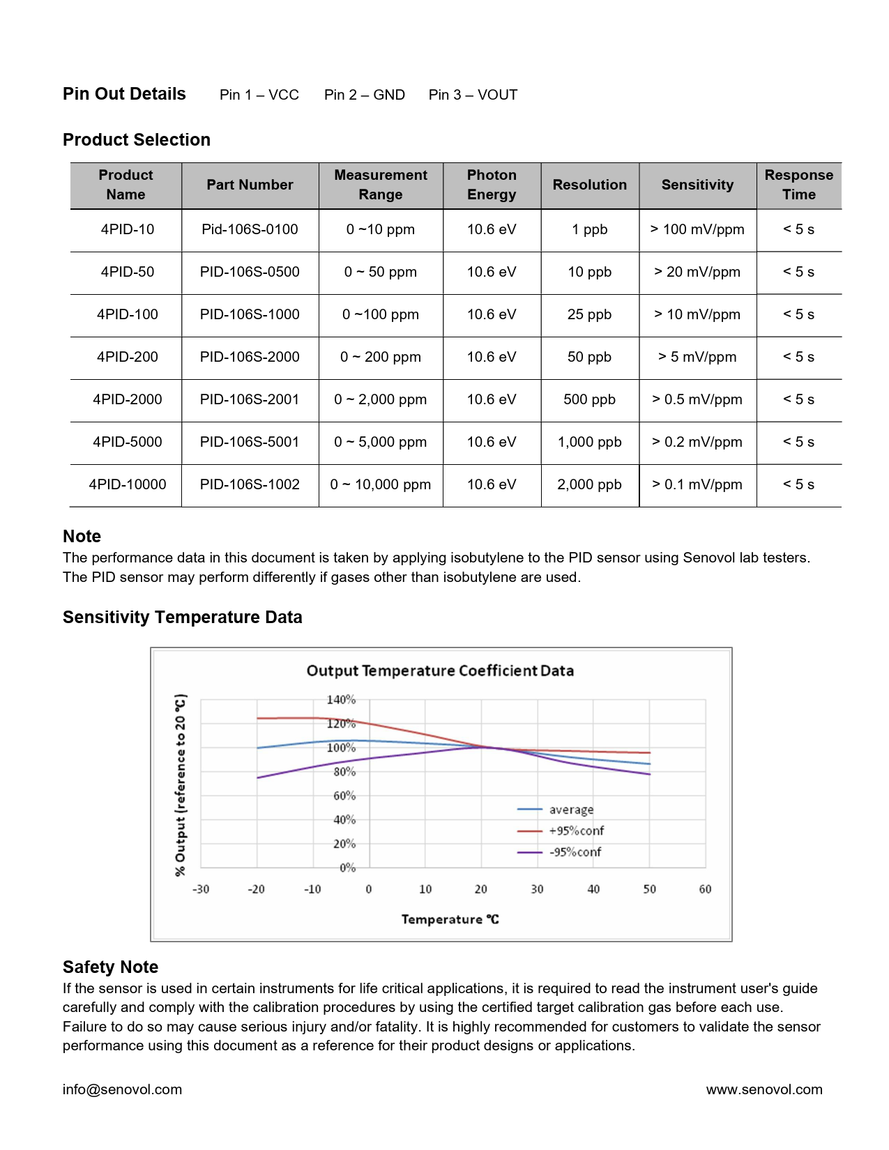

Pages / Page2 / 2 — Pin. Out. Details. Pin. 1. –. VCC. Pin. 2. –. GND. Pin. 3. –. VOUT. …
File Format / SizePDF / 600 Kb
Pin. Out. Details. Pin. 1. –. VCC. Pin. 2. –. GND. Pin. 3. –. VOUT. Product. Selection. Product. Measurement. Photon. Response. Part. Number. Resolution. Sensitivity
Pin Out Details Pin 1 – VCC Pin 2 – GND Pin 3 – VOUT Product Selection Product Measurement Photon Response Part Number Resolution Sensitivity
Pin Out Details Pin 1 – VCC Pin 2 – GND Pin 3 – VOUT Product Selection Product Measurement Photon Response Part Number Resolution Sensitivity Name Range Energy Time 4PID-10 Pid-106S-0100 0 ~10 ppm 10.6 eV 1 ppb > 100 mV/ppm < 5 s 4PID-50 PID-106S-0500 0 ~ 50 ppm 10.6 eV 10 ppb > 20 mV/ppm < 5 s 4PID-100 PID-106S-1000 0 ~100 ppm 10.6 eV 25 ppb > 10 mV/ppm < 5 s 4PID-200 PID-106S-2000 0 ~ 200 ppm 10.6 eV 50 ppb > 5 mV/ppm < 5 s 4PID-2000 PID-106S-2001 0 ~ 2,000 ppm 10.6 eV 500 ppb > 0.5 mV/ppm < 5 s 4PID-5000 PID-106S-5001 0 ~ 5,000 ppm 10.6 eV 1,000 ppb > 0.2 mV/ppm < 5 s 4PID-10000 PID-106S-1002 0 ~ 10,000 ppm 10.6 eV 2,000 ppb > 0.1 mV/ppm < 5 s Note The performance data in this document is taken by applying isobutylene to the PID sensor using Senovol lab testers. The PID sensor may perform differently if gases other than isobutylene are used. Sensitivity Temperature Data Safety Note If the sensor is used in certain instruments for life critical applications, it is required to read the instrument user's guide carefully and comply with the calibration procedures by using the certified target calibration gas before each use. Failure to do so may cause serious injury and/or fatality. It is highly recommended for customers to validate the sensor performance using this document as a reference for their product designs or applications. info@senovol.com www.senovol.com
