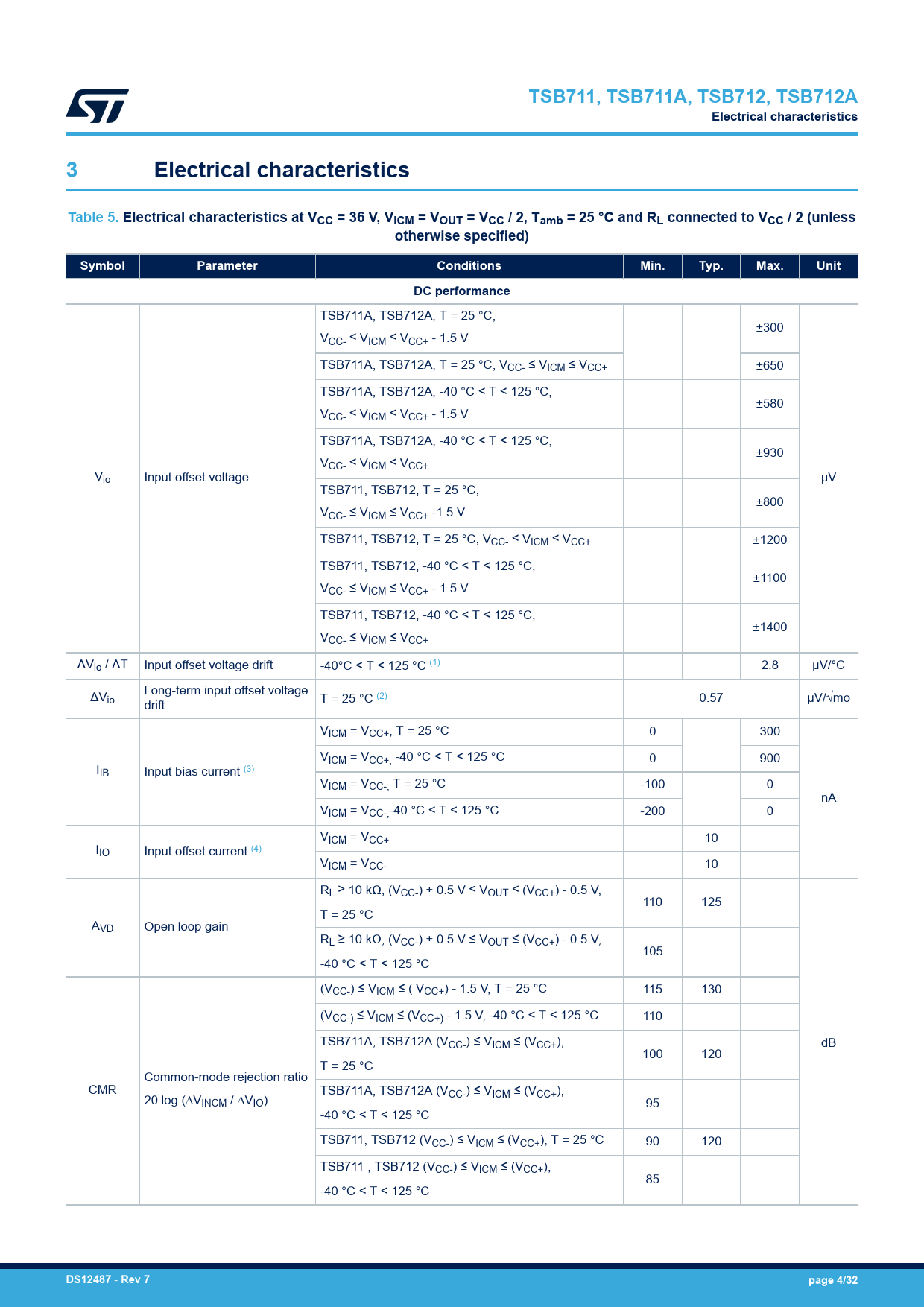

DescriptionPrecision Rail-To-Rail Input/Output 36 V, 6 MHz Op Amps

TSB711, TSB711A, TSB712, TSB712A Electrical characteristics 3 Electrical characteristics Table 5. Electrical characteristics at VCC = 36 V, VICM = VOUT = VCC / 2, Tamb = 25 °C and RL connected to VCC / 2 (unless otherwise specified) Symbol Parameter Conditions Min. Typ. Max. Unit DC performance
TSB711A, TSB712A, T = 25 °C, ±300 VCC- ≤ VICM ≤ VCC+ - 1.5 V TSB711A, TSB712A, T = 25 °C, VCC- ≤ VICM ≤ VCC+ ±650 TSB711A, TSB712A, -40 °C < T < 125 °C, ±580 VCC- ≤ VICM ≤ VCC+ - 1.5 V TSB711A, TSB712A, -40 °C < T < 125 °C, ±930 VCC- ≤ VICM ≤ VCC+ Vio Input offset voltage µV TSB711, TSB712, T = 25 °C, ±800 VCC- ≤ VICM ≤ VCC+ -1.5 V TSB711, TSB712, T = 25 °C, VCC- ≤ VICM ≤ VCC+ ±1200 TSB711, TSB712, -40 °C < T < 125 °C, ±1100 VCC- ≤ VICM ≤ VCC+ - 1.5 V TSB711, TSB712, -40 °C < T < 125 °C, ±1400 VCC- ≤ VICM ≤ VCC+ ΔVio / ΔT Input offset voltage drift -40°C < T < 125 °C (1) 2.8 µV/°C ΔV Long-term input offset voltage io drift T = 25 °C (2) 0.57 µV/√mo VICM = VCC+, T = 25 °C 0 300 VICM = VCC+, -40 °C < T < 125 °C 0 900 IIB Input bias current (3) VICM = VCC-, T = 25 °C -100 0 nA VICM = VCC-,-40 °C < T < 125 °C -200 0 VICM = VCC+ 10 IIO Input offset current (4) VICM = VCC- 10 RL ≥ 10 kΩ, (VCC-) + 0.5 V ≤ VOUT ≤ (VCC+) - 0.5 V, 110 125 T = 25 °C AVD Open loop gain RL ≥ 10 kΩ, (VCC-) + 0.5 V ≤ VOUT ≤ (VCC+) - 0.5 V, 105 -40 °C < T < 125 °C (VCC-) ≤ VICM ≤ ( VCC+) - 1.5 V, T = 25 °C 115 130 (VCC-) ≤ VICM ≤ (VCC+) - 1.5 V, -40 °C < T < 125 °C 110 TSB711A, TSB712A (VCC-) ≤ VICM ≤ (VCC+), dB 100 120 T = 25 °C Common-mode rejection ratio CMR TSB711A, TSB712A (V 20 log (∆V CC-) ≤ VICM ≤ (VCC+), INCM / ∆VIO) 95 -40 °C < T < 125 °C TSB711, TSB712 (VCC-) ≤ VICM ≤ (VCC+), T = 25 °C 90 120 TSB711 , TSB712 (VCC-) ≤ VICM ≤ (VCC+), 85 -40 °C < T < 125 °C
