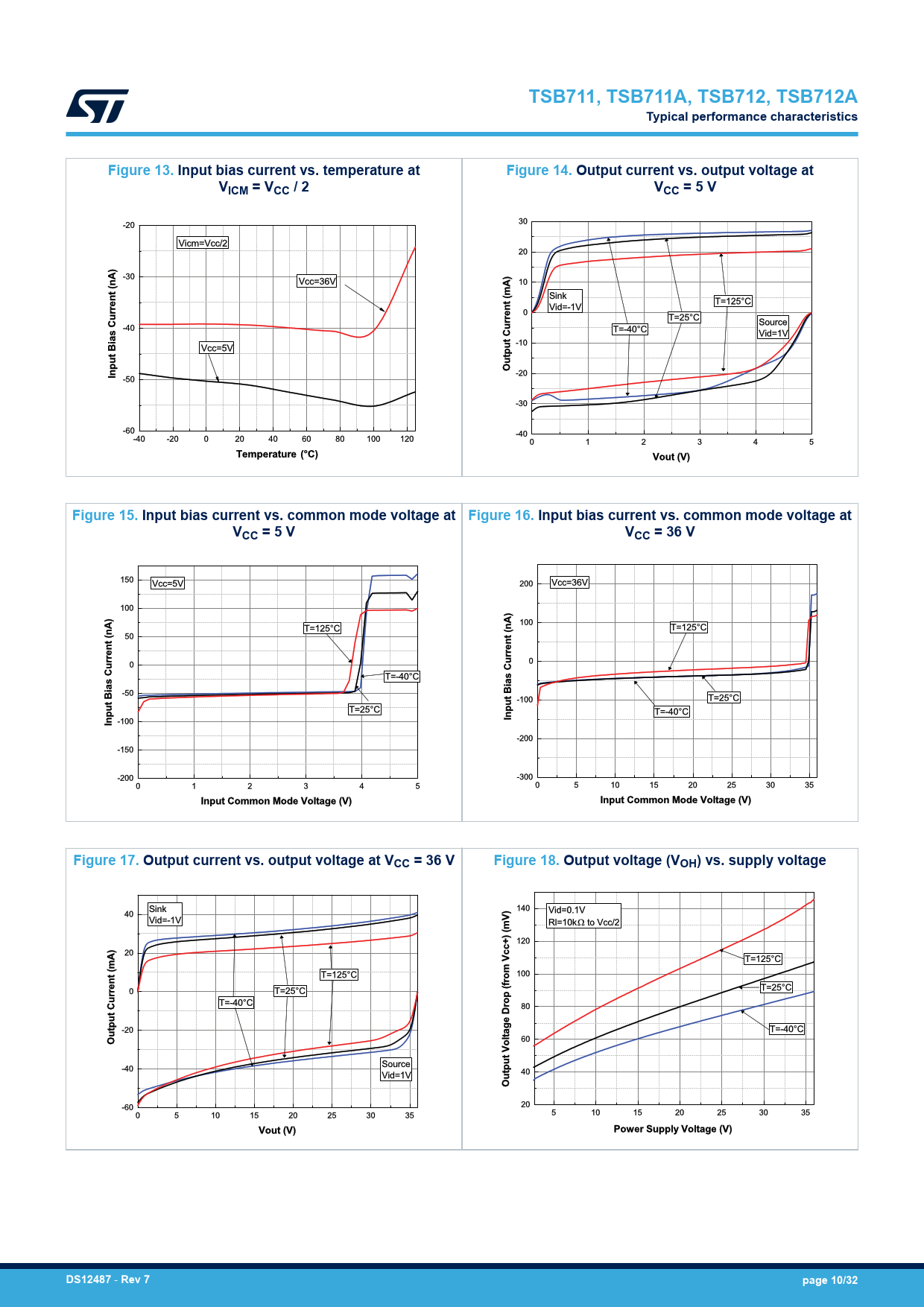

TSB711, TSB711A, TSB712, TSB712A. Typical performance characteristics. Figure 13. Input bias current vs. temperature at
TSB711, TSB711A, TSB712, TSB712A Typical performance characteristics Figure 13 Input bias current vs temperature at
TSB711, TSB711A, TSB712, TSB712A Typical performance characteristics Figure 13. Input bias current vs. temperature at Figure 14. Output current vs. output voltage at VICM = VCC / 2 VCC = 5 V Figure 15. Input bias current vs. common mode voltage at Figure 16. Input bias current vs. common mode voltage at VCC = 5 V VCC = 36 V Figure 17. Output current vs. output voltage at VCC = 36 V Figure 18. Output voltage (VOH) vs. supply voltage DS12487
