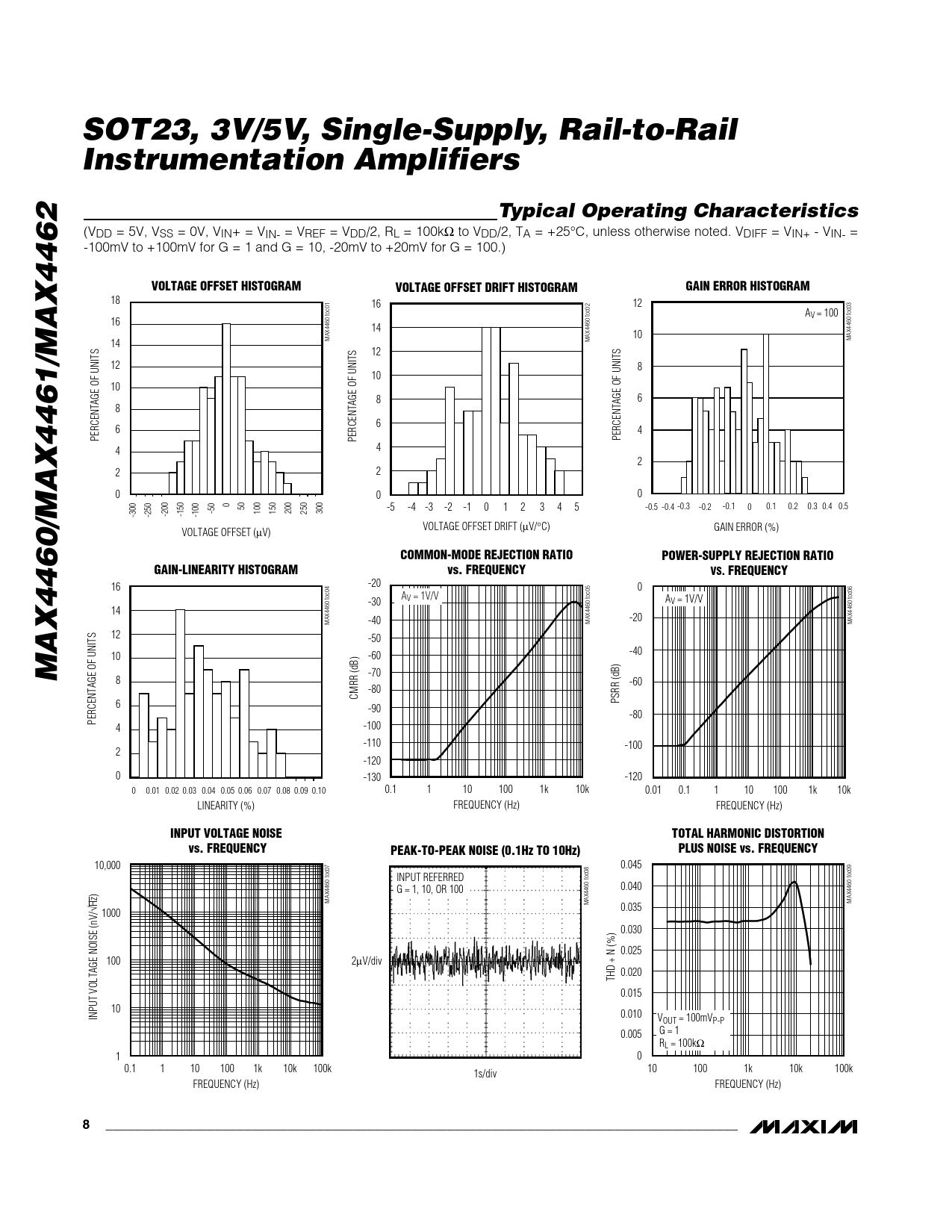

SOT23, 3V/5V, Single-Supply, Rail-to-Rail Instrumentation Amplifiers. Typical Operating Characteristics
SOT23, 3V/5V, Single-Supply, Rail-to-Rail Instrumentation Amplifiers Typical Operating Characteristics
(VDD = 5V, VSS = 0V, VIN+ = VIN- = VREF = VDD/2, RL = 100kΩ to VDD/2, TA = +25°C, unless otherwise noted. VDIFF = VIN+ - VIN- = -100mV to +100mV for G = 1 and G = 10, -20mV to +20mV for G = 100.)
VOLTAGE OFFSET HISTOGRAM VOLTAGE OFFSET DRIFT HISTOGRAM GAIN ERROR HISTOGRAM
18 16 12 AV = 100 16 14 10 MAX4460 toc03 14 MAX4460 toc01 MAX4460 toc02 12 12 8 10 10 8 6 8 6 6 4 PERCENTAGE OF UNITS PERCENTAGE OF UNITS PERCENTAGE OF UNITS 4 4 2 2 2 0 0 0 0 50 -5 -4 -3 -2 -1 0 1 2 3 4 5 -0.5 -0.4 -0.3 -0.2 -0.1 0 0.1 0.2 0.3 0.4 0.5 -300 -250 -200 -150 -100 -50 100 150 200 250 300 VOLTAGE OFFSET DRIFT (µV/°C) GAIN ERROR (%) VOLTAGE OFFSET (µV)
COMMON-MODE REJECTION RATIO POWER-SUPPLY REJECTION RATIO GAIN-LINEARITY HISTOGRAM vs. FREQUENCY VS. FREQUENCY
16 -20 0 A -30 V = 1V/V AV = 1V/V 14 -20 MAX4460 toc04 -40 MAX4460 toc05 MAX4460 toc06 12 -50 -40 10 -60
MAX4460/MAX4461/MAX4462
-70 8 -60 -80 CMRR (dB) 6 PSRR (dB) -90 -80 PERCENTAGE OF UNITS 4 -100 -110 -100 2 -120 0 -130 -120 0 0.01 0.02 0.03 0.04 0.05 0.06 0.07 0.08 0.09 0.10 0.1 1 10 100 1k 10k 0.01 0.1 1 10 100 1k 10k LINEARITY (%) FREQUENCY (Hz) FREQUENCY (Hz)
INPUT VOLTAGE NOISE TOTAL HARMONIC DISTORTION vs. FREQUENCY PEAK-TO-PEAK NOISE (0.1Hz TO 10Hz) PLUS NOISE vs. FREQUENCY
10,000 0.045 INPUT REFERRED G = 1, 10, OR 100 0.040 MAX4460 toc07 MAX4460 toc09 √Hz) MAX4460 toc08 0.035 1000 0.030 0.025 100 2µV/div 0.020 THD + N (%) 0.015 10 INPUT VOLTAGE NOISE (nV/ 0.010 VOUT = 100mVP-P 0.005 G = 1 RL = 100kΩ 1 0 0.1 1 10 100 1k 10k 100k 10 100 1k 10k 100k 1s/div FREQUENCY (Hz) FREQUENCY (Hz)
