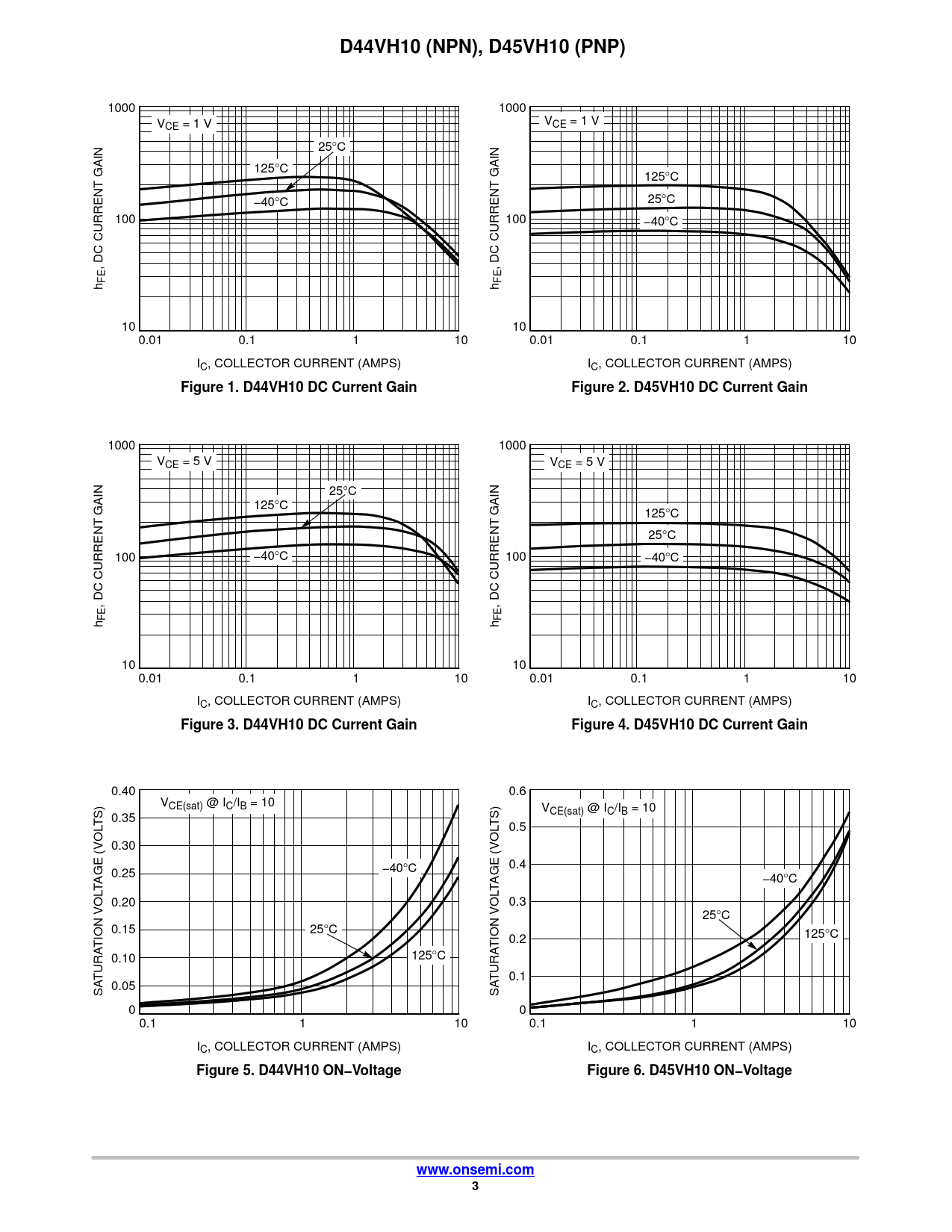

Pages / Page5 / 3 — D44VH10 (NPN), D45VH10 (PNP). Figure 1. D44VH10 DC Current Gain. Figure …
File Format / SizePDF / 116 Kb
D44VH10 (NPN), D45VH10 (PNP). Figure 1. D44VH10 DC Current Gain. Figure 2. D45VH10 DC Current Gain
D44VH10 (NPN), D45VH10 (PNP) Figure 1 D44VH10 DC Current Gain Figure 2 D45VH10 DC Current Gain
1000 1000 V V CE = 1 V CE = 1 V 25°C 125°C 125°C −40°C 25°C 100 100 −40°C , DC CURRENT GAIN , DC CURRENT GAIN FE FE h h 10 10 0.01 0.1 1 10 0.01 0.1 1 10 IC, COLLECTOR CURRENT (AMPS) IC, COLLECTOR CURRENT (AMPS)
Figure 1. D44VH10 DC Current Gain Figure 2. D45VH10 DC Current Gain
1000 1000 VCE = 5 V VCE = 5 V 25°C 125°C 125°C 25°C 100 −40°C 100 −40°C , DC CURRENT GAIN , DC CURRENT GAIN FE FE h h 10 10 0.01 0.1 1 10 0.01 0.1 1 10 IC, COLLECTOR CURRENT (AMPS) IC, COLLECTOR CURRENT (AMPS)
Figure 3. D44VH10 DC Current Gain Figure 4. D45VH10 DC Current Gain
0.40 0.6 VCE(sat) @ IC/IB = 10 VCE(sat) @ IC/IB = 10 TS) 0.35 TS) 0.5 0.30 −40°C 0.4 0.25 AGE (VOL AGE (VOL −40°C T T 0.20 0.3 25°C 0.15 25°C 125°C TION VOL TION VOL 0.2 125 0.10 °C TURA TURA 0.1 0.05 SA SA 0 0 0.1 1 10 0.1 1 10 IC, COLLECTOR CURRENT (AMPS) IC, COLLECTOR CURRENT (AMPS)
Figure 5. D44VH10 ON−Voltage Figure 6. D45VH10 ON−Voltage www.onsemi.com 3
