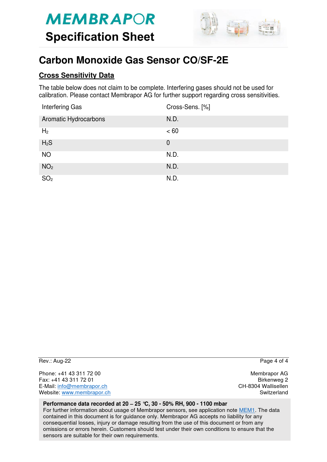

Carbon Monoxide Gas Sensor CO/SF-2E. Cross Sensitivity Data
Carbon Monoxide Gas Sensor CO/SF-2E Cross Sensitivity Data
The table below does not claim to be complete. Interfering gases should not be used for calibration. Please contact Membrapor AG for further support regarding cross sensitivities. Interfering Gas Cross-Sens. [%] Aromatic Hydrocarbons N.D. H2 < 60 H2S 0 NO N.D. NO2 N.D. SO2 N.D. Rev.: Aug-22 Page 4 of 4 Phone: +41 43 311 72 00 Membrapor AG Fax: +41 43 311 72 01 Birkenweg 2 E-Mail: info@membrapor.ch CH-8304 Wallisellen Website: www.membrapor.ch Switzerland
Performance data recorded at 20 – 25 °C, 30 - 50% RH, 900 - 1100 mbar
For further information about usage of Membrapor sensors, see application note MEM1. The data contained in this document is for guidance only. Membrapor AG accepts no liability for any consequential losses, injury or damage resulting from the use of this document or from any omissions or errors herein. Customers should test under their own conditions to ensure that the sensors are suitable for their own requirements.
