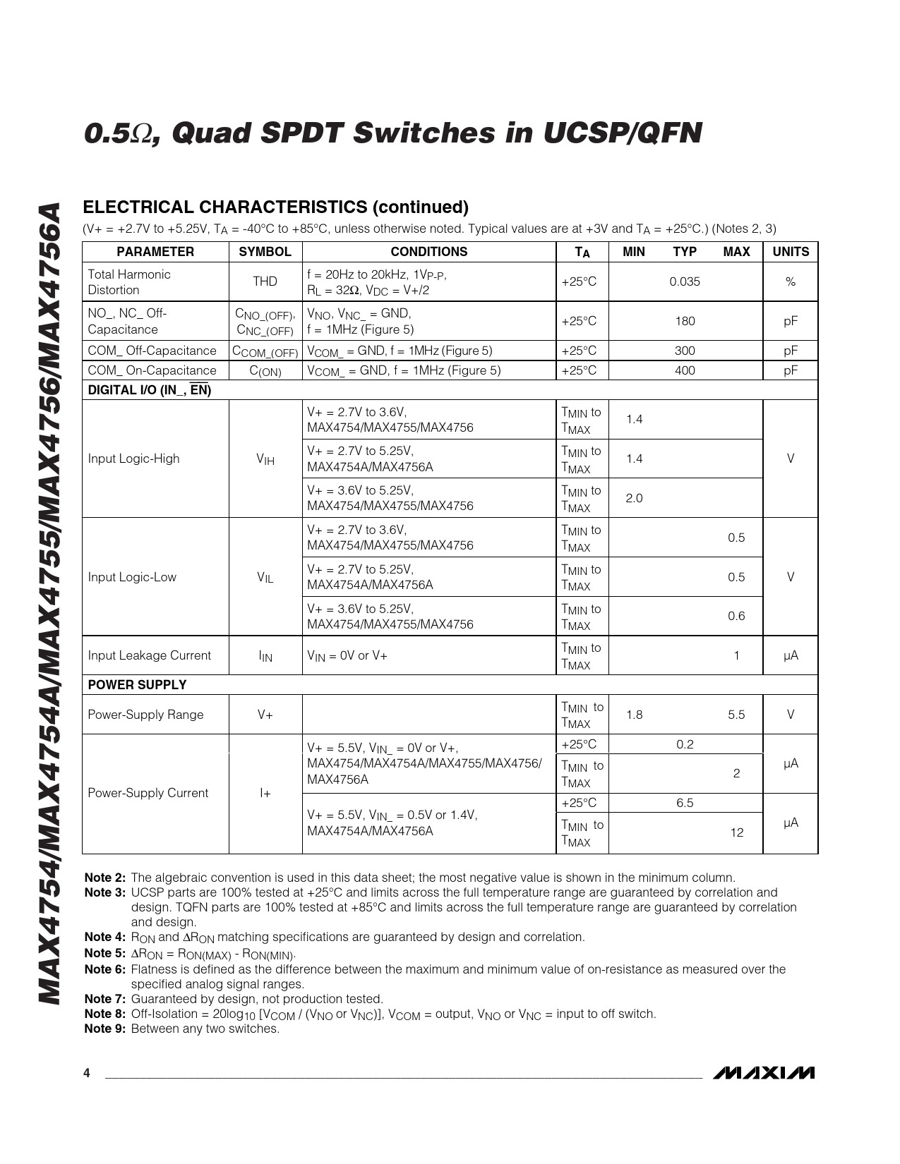

0.5. , Quad SPDT Switches in UCSP/QFN. ELECTRICAL CHARACTERISTICS (continued). PARAMETER. SYMBOL. CONDITIONS. MIN. TYP. MAX. UNITS
0.5 , Quad SPDT Switches in UCSP/QFN ELECTRICAL CHARACTERISTICS (continued) PARAMETER SYMBOL CONDITIONS MIN TYP MAX UNITS
0.5
Ω
(V+ = +2.7V to +5.25V, TA = -40°C to +85°C, unless otherwise noted. Typical values are at +3V and TA = +25°C.) (Notes 2, 3)
PARAMETER SYMBOL CONDITIONS TA MIN TYP MAX UNITS
Total Harmonic f = 20Hz to 20kHz, 1V THD P-P, +25°C 0.035 % Distortion RL = 32Ω, VDC = V+/2 NO_, NC_ Off- CNO_(OFF), VNO, VNC_ = GND, +25°C 180 pF Capacitance CNC_(OFF) f = 1MHz (Figure 5) COM_ Off-Capacitance CCOM_(OFF) V C OM _ = G N D , f = 1M H z ( Fi g ur e 5) +25°C 300 pF COM_ On-Capacitance C(ON) VCOM_ = GND, f = 1MHz (Figure 5) +25°C 400 pF
DIGITAL I/O (IN_,
EN
V+ = 2.7V to 3.6V, TMIN to 1.4 MAX4754/MAX4755/MAX4756 TMAX V+ = 2.7V to 5.25V, TMIN to Input Logic-High VIH 1.4 V MAX4754A/MAX4756A TMAX V+ = 3.6V to 5.25V, TMIN to 2.0 MAX4754/MAX4755/MAX4756 TMAX V+ = 2.7V to 3.6V, TMIN to 0.5 MAX4754/MAX4755/MAX4756 TMAX V+ = 2.7V to 5.25V, TMIN to Input Logic-Low VIL 0.5 V MAX4754A/MAX4756A TMAX V+ = 3.6V to 5.25V, TMIN to 0.6 MAX4754/MAX4755/MAX4756 TMAX T Input Leakage Current I MIN to IN VIN = 0V or V+ 1 µA TMAX
POWER SUPPLY
T Power-Supply Range V+ MIN to 1.8 5.5 V TMAX +25°C 0.2 V+ = 5.5V, VIN_ = 0V or V+, MAX4754/MAX4754A/MAX4755/MAX4756/ TMIN to µA 2 MAX4756A TMAX Power-Supply Current I+ +25°C 6.5 V+ = 5.5V, VIN_ = 0.5V or 1.4V, T µA MAX4754A/MAX4756A MIN to 12 TMAX
Note 2:
The algebraic convention is used in this data sheet; the most negative value is shown in the minimum column.
Note 3:
UCSP parts are 100% tested at +25°C and limits across the full temperature range are guaranteed by correlation and design. TQFN parts are 100% tested at +85°C and limits across the full temperature range are guaranteed by correlation and design.
Note 4:
RON and ΔRON matching specifications are guaranteed by design and correlation.
Note 5:
ΔRON = RON(MAX) - RON(MIN).
Note 6:
Flatness is defined as the difference between the maximum and minimum value of on-resistance as measured over the specified analog signal ranges.
MAX4754/MAX4754A/MAX4755/MAX4756/MAX4756A Note 7:
Guaranteed by design, not production tested.
Note 8:
Off-Isolation = 20log10 [VCOM / (VNO or VNC)], VCOM = output, VNO or VNC = input to off switch.
Note 9:
Between any two switches.
