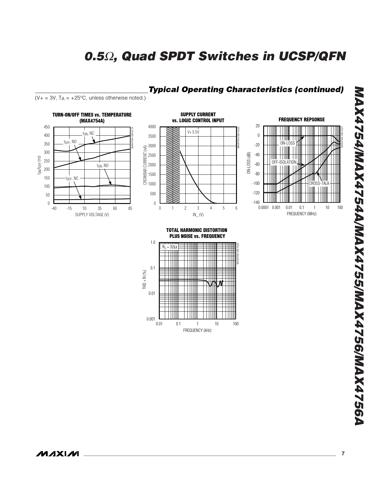

, Quad SPDT Switches in UCSP/QFN MAX4754/MAX4754A/MAX4755/MAX4756/MAX4756A Typical Operating Characteristics (continued)
(V+ = 3V, TA = +25°C, unless otherwise noted.)
TURN-ON/OFF TIMES vs. TEMPERATURE SUPPLY CURRENT (MAX4754A) vs. LOGIC CONTROL INPUT FREQUENCY REPSONSE
450 4000 20 t V+ 5.5V 400 ON, NC 3500 0 t 350 OFF, NO ON-LOSS 3000 -20 MAX4754A-56A toc19 MAX4754A-56A toc20 MAX4754A-56A toc21 300 2500 -40 (ns) 250 OFF-ISOLATION t 2000 -60 /t OFF ON, NO 200 t ON ON-LOSS (dB) 1500 -80 150 tOFF, NC CROWBAR CURRENT (nA) 1000 -100 CROSS-TALK 100 -120 50 500 0 0 -140 -40 -15 10 35 60 85 0 1 2 3 4 5 6 0.0001 0.001 0.01 0.1 1 10 100 SUPPLY VOLTAGE (V) IN_ (V) FREQUENCY (MHz)
TOTAL HARMONIC DISTORTION PLUS NOISE vs. FREQUENCY
1.0 RL = 32Ω MAX4754A-56A toc22 0.1 THD + N (%) 0.01 0.001 0.01 0.1 1 10 100 FREQUENCY (kHz)
