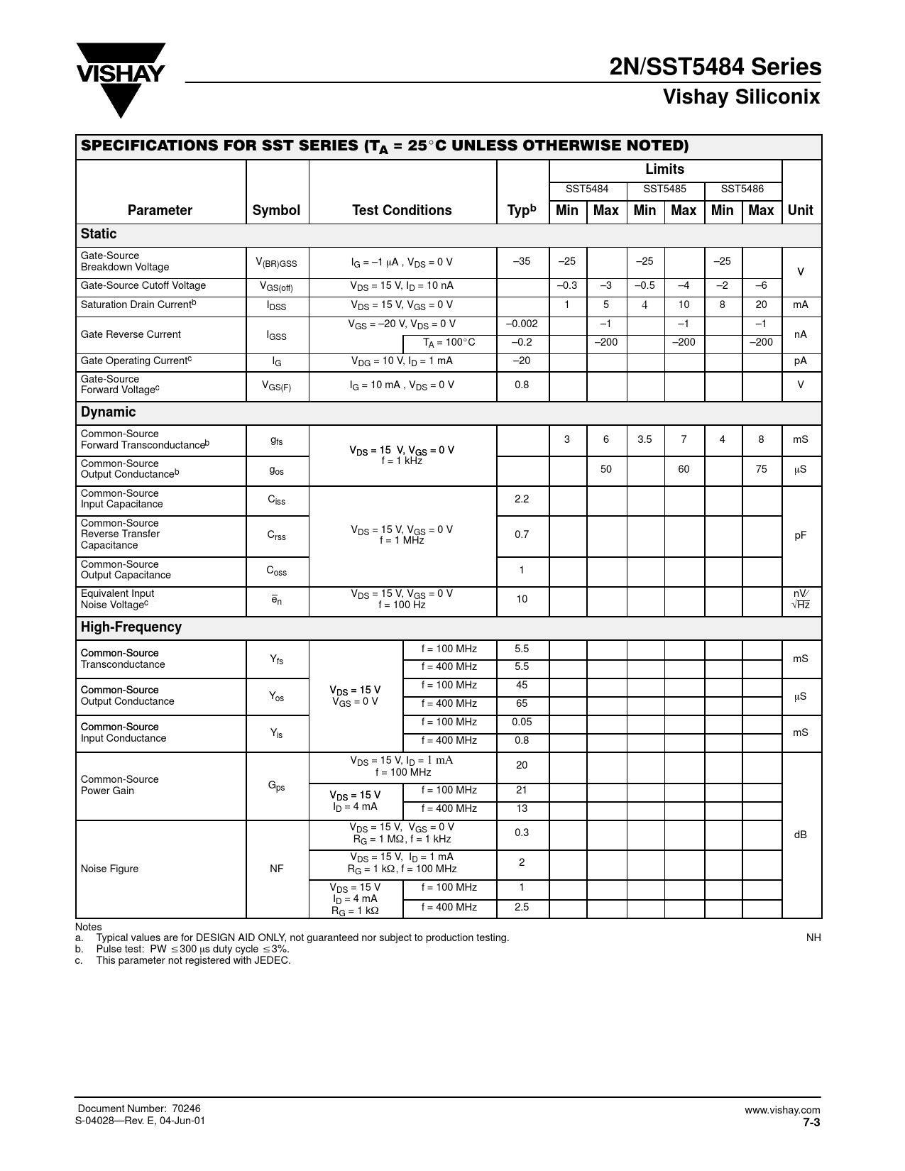

2N/SST5484 Series Vishay Siliconix
SPECIFICATIONS FOR SST SERIES (TA = 25_C UNLESS OTHERWISE NOTED)
Limits
SST5484 SST5485 SST5486
Parameter Symbol Test Conditions Typb Min Max Min Max Min Max Unit Static
Gate-Source V Breakdown Voltage (BR)GSS IG = –1 A , VDS = 0 V –35 –25 –25 –25 V Gate-Source Cutoff Voltage VGS(off) VDS = 15 V, ID = 10 nA –0.3 –3 –0.5 –4 –2 –6 Saturation Drain Currentb IDSS VDS = 15 V, VGS = 0 V 1 5 4 10 8 20 mA VGS = –20 V, VDS = 0 V –0.002 –1 –1 –1 Gate Reverse Current IGSS nA TA = 100_C –0.2 –200 –200 –200 Gate Operating Currentc IG VDG = 10 V, ID = 1 mA –20 pA Gate-Source Forward Voltagec VGS(F) IG = 10 mA , VDS = 0 V 0.8 V
Dynamic
Common-Source 3 6 3.5 7 4 8 mS Forward Transconductanceb gfs VDS = 15 V, V DS = 15 V, GS V = 0 V GS Common-Source f = 1 kHz 50 60 75 S Output Conductanceb gos Common-Source C Input Capacitance iss 2.2 Common-Source V Reverse Transfer C DS = 15 V, VGS = 0 V rss 0.7 pF f = 1 MHz Capacitance Common-Source C Output Capacitance oss 1 Equivalent Input VDS = 15 V, VGS = 0 V nV⁄ 10 Noise Voltagec en f = 100 Hz √Hz
High-Frequency
Common-Source f = 100 MHz 5.5 Common-Source Y mS Transconductance fs f = 400 MHz 5.5 f = 100 MHz 45 Common-Source VDS = 15 V Y DS os S Output Conductance VGS = 0 V f = 400 MHz 65 f = 100 MHz 0.05 Common-Source Y mS Input Conductance is f = 400 MHz 0.8 VDS = 15 V, ID = 1 mA 20 f = 100 MHz Common-Source G Power Gain ps f = 100 MHz 21 VDS = 15 V DS ID = 4 mA f = 400 MHz 13 VDS = 15 V, VGS = 0 V 0.3 R dB G = 1 M , f = 1 kHz VDS = 15 V, ID = 1 mA 2 Noise Figure NF RG = 1 k , f = 100 MHz VDS = 15 V f = 100 MHz 1 ID = 4 mA RG = 1 k f = 400 MHz 2.5 Notes a. Typical values are for DESIGN AID ONLY, not guaranteed nor subject to production testing. NH b. Pulse test: PW v300 s duty cycle v3%. c. This parameter not registered with JEDEC. Document Number: 70246 www.vishay.com S-04028—Rev. E, 04-Jun-01
