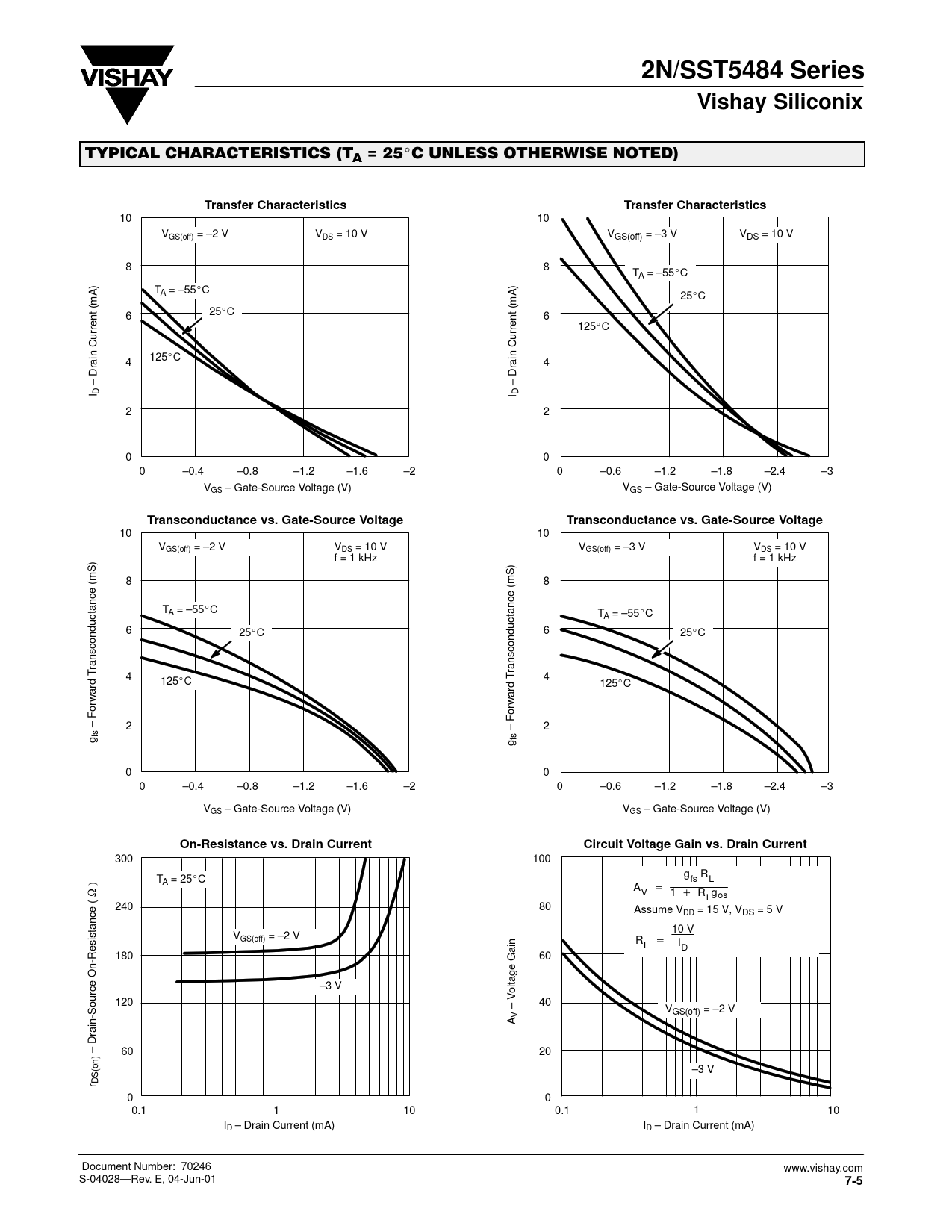

2N/SST5484 Series. Vishay Siliconix. Transfer Characteristics. Transconductance vs. Gate-Source Voltage
2N/SST5484 Series Vishay Siliconix Transfer Characteristics Transconductance vs Gate-Source Voltage
TYPICAL CHARACTERISTICS (TA = 25_C UNLESS OTHERWISE NOTED)
Transfer Characteristics Transfer Characteristics
10 10 VGS(off) = –2 V VDS = 10 V VGS(off) = –3 V VDS = 10 V 8 8 TA = –55_C TA = –55_C 25_C 6 25_C 6 125_C 125_C 4 4 Drain Current (mA) Drain Current (mA) – – I D I D 2 2 0 0 0 –0.4 –0.8 –1.2 –1.6 –2 0 –0.6 –1.2 –1.8 –2.4 –3 VGS – Gate-Source Voltage (V) VGS – Gate-Source Voltage (V)
Transconductance vs. Gate-Source Voltage Transconductance vs. Gate-Source Voltage
10 10 VGS(off) = –2 V VDS = 10 V VGS(off) = –3 V VDS = 10 V f = 1 kHz f = 1 kHz 8 8 TA = –55_C TA = –55_C 6 25_C 6 25_C ransconductance (mS) ransconductance (mS) 4 125_C 4 125_C Forward T Forward T – 2 2 – fsg fsg 0 0 0 –0.4 –0.8 –1.2 –1.6 –2 0 –0.6 –1.2 –1.8 –2.4 –3 VGS – Gate-Source Voltage (V) VGS – Gate-Source Voltage (V)
On-Resistance vs. Drain Current Circuit Voltage Gain vs. Drain Current
300 100 T g R A = 25_C fs L A + Ω ) V 1 ) R g L os 240 80 Assume VDD = 15 V, VDS = 5 V 10 V VGS(off) = –2 V R + L ID 180 60 –3 V oltage Gain 120 V 40 – VGS(off) = –2 V VA Drain-Source On-Resistance ( – 60 20 (on) –3 V r DS 0 0 0.1 1 10 0.1 1 10 ID – Drain Current (mA) ID – Drain Current (mA) Document Number: 70246 www.vishay.com S-04028—Rev. E, 04-Jun-01
