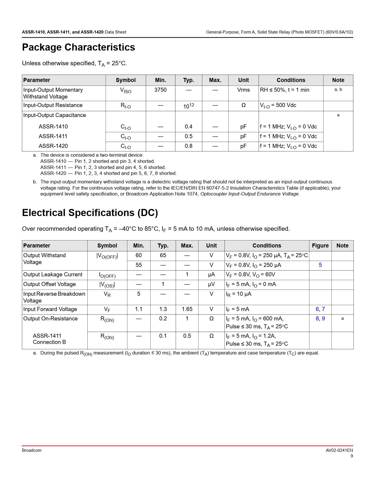

ASSR-1410, ASSR-1411, and ASSR-1420. Package Characteristics. Parameter. Symbol. Min. Typ. Max. Unit. Conditions. Note
ASSR-1410, ASSR-1411, and ASSR-1420 Package Characteristics Parameter Symbol Min Typ Max Unit Conditions Note
link to page 11 link to page 9 link to page 11 link to page 12 link to page 12 link to page 12
Data Sheet General-Purpose, Form A, Solid State Relay (Photo MOSFET) (60V/0.6A/1Ω)
Unless otherwise specified, TA = 25°C.
Parameter Symbol Min. Typ. Max. Unit Conditions Note
Input-Output Momentary VISO 3750 — — Vrms RH ≤ 50%, t = 1 min a, b Withstand Voltage Input-Output Resistance RI-O — 1012 — Ω VI-O = 500 Vdc Input-Output Capacitance a ASSR-1410 CI-O — 0.4 — pF f = 1 MHz; VI-O = 0 Vdc ASSR-1411 CI-O — 0.5 — pF f = 1 MHz; VI-O = 0 Vdc ASSR-1420 CI-O — 0.8 — pF f = 1 MHz; VI-O = 0 Vdc a. The device is considered a two-terminal device: ASSR-1410 — Pin 1, 2 shorted and pin 3, 4 shorted. ASSR-1411 — Pin 1, 2, 3 shorted and pin 4, 5, 6 shorted. ASSR-1420 — Pin 1, 2, 3, 4 shorted and pin 5, 6, 7, 8 shorted. b. The input-output momentary withstand voltage is a dielectric voltage rating that should not be interpreted as an input-output continuous voltage rating. For the continuous voltage rating, refer to the IEC/EN/DIN EN 60747-5-2 Insulation Characteristics Table (if applicable), your equipment level safety specification, or Broadcom Application Note 1074, Optocoupler Input-Output Endurance Voltage.
Electrical Specifications (DC)
Over recommended operating TA = –40°C to 85°C, IF = 5 mA to 10 mA, unless otherwise specified.
Parameter Symbol Min. Typ. Max. Unit Conditions Figure Note
Output Withstand |VO(OFF)| 60 65 — V VF = 0.8V, IO = 250 μA, TA = 25°C Voltage 55 — — V VF = 0.8V, IO = 250 μA 5 Output Leakage Current IO(OFF) — — 1 μA VF = 0.8V, VO = 60V Output Of set Voltage |V(OS)| — 1 — μV IF = 5 mA, IO = 0 mA Input Reverse Breakdown VR 5 — — V IR = 10 μA Voltage Input Forward Voltage VF 1.1 1.3 1.65 V IF = 5 mA 6, 7 Output On-Resistance R(ON) — 0.2 1 Ω IF = 5 mA, IO = 600 mA, 8, 9 a Pulse ≤ 30 ms, TA = 25°C ASSR-1411 R(ON) — 0.1 0.5 Ω IF = 5 mA, IO = 1.2A, Connection B Pulse ≤ 30 ms, TA = 25°C a. During the pulsed R(ON) measurement (IO duration ≤ 30 ms), the ambient (TA) temperature and case temperature (TC) are equal. Broadcom AV02-0241EN9 Document Outline Description Features Applications Functional Diagram Truth Table Ordering Information Schematics ASSR-1410 ASSR-1411 Connection A ASSR-1411 Connection B ASSR-1420 Package Outline Drawings ASSR-1410 4-Pin Small Outline Package ASSR-1411 6-Pin DIP Package ASSR-1411 6-Pin DIP Package with Gull Wing Surface Mount Option 300 ASSR-1420 8-Pin DIP Package ASSR-1420 8-Pin DIP Package with Gull Wing Surface Mount Option 300 Solder Reflow Profile Regulatory Information Insulation and Safety Related Specifications Absolute Maximum Ratings Recommended Operating Conditions Package Characteristics Electrical Specifications (DC) Switching Specifications (AC) Applications Information On-Resistance and Derating Curves Turn-On Time and Turn-Off Time Variation
