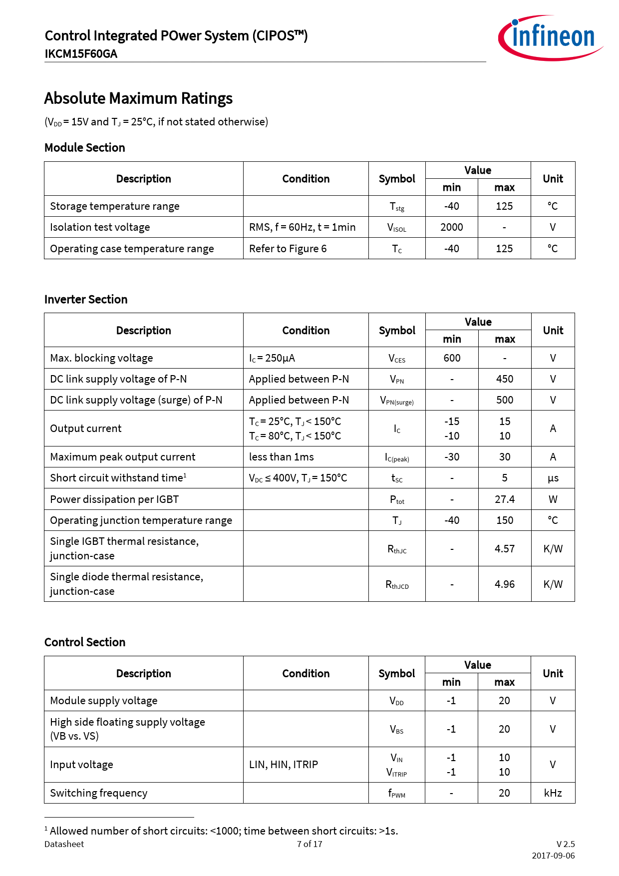

Control. Integrated. POwer. System. (CIPOS™). IKCM15F60GA. Absolute. Maximum. Ratings. (VDD. =. 15V. and. TJ. =. 25°C,. if. not. stated. otherwise). Module
Control Integrated POwer System (CIPOS™) IKCM15F60GA Absolute Maximum Ratings (VDD = 15V and TJ = 25°C, if not stated otherwise) Module
Control Integrated POwer System (CIPOS™) IKCM15F60GA Absolute Maximum Ratings (VDD = 15V and TJ = 25°C, if not stated otherwise) Module Section Value Description Condition Symbol Unit min max Storage temperature range Tstg -40 125 °C Isolation test voltage RMS, f = 60Hz, t = 1min VISOL 2000 - V Operating case temperature range Refer to Figure 6 TC -40 125 °C Inverter Section Value Description Condition Symbol Unit min max Max. blocking voltage IC = 250µA VCES 600 - V DC link supply voltage of P-N Applied between P-N VPN - 450 V DC link supply voltage (surge) of P-N Applied between P-N VPN(surge) - 500 V T -15 15 Output current C = 25°C, TJ < 150°C I A T C C = 80°C, TJ < 150°C -10 10 Maximum peak output current less than 1ms IC(peak) -30 30 A Short circuit withstand time1 VDC ≤ 400V, TJ = 150°C tSC - 5 µs Power dissipation per IGBT Ptot - 27.4 W Operating junction temperature range TJ -40 150 °C Single IGBT thermal resistance, R junction-case thJC - 4.57 K/W Single diode thermal resistance, R junction-case thJCD - 4.96 K/W Control Section Value Description Condition Symbol Unit min max Module supply voltage VDD -1 20 V High side floating supply voltage V (VB vs. VS) BS -1 20 V V -1 10 Input voltage LIN, HIN, ITRIP IN V VITRIP -1 10 Switching frequency fPWM - 20 kHz 1 Allowed number of short circuits: <1000; time between short circuits: >1s. Datasheet 7 of 17 V 2.5 2017-09-06 Document Outline Table of contents CIPOS™ Control Integrated POwer System Features Target Applications Description System Configuration Pin Configuration Internal Electrical Schematic Pin Assignment Pin Description HIN(U, V, W) and LIN(U, V, W) (Low side and high side control pins, Pin 7 - 12) VFO (Fault-output and NTC, Pin 14) ITRIP (Over current detection function, Pin 15) VDD, VSS (Low side control supply and reference, Pin 13, 16) VB(U, V, W) and VS(U, V, W) (High side supplies, Pin 1 - 6) NW, NV, NU (Low side emitter, Pin 17 - 19) W, V, U (High side emitter and low side collector, Pin 20 - 22) P (Positive bus input voltage, Pin 23) Absolute Maximum Ratings Module Section Inverter Section Control Section Recommended Operation Conditions Static Parameters Dynamic Parameters Bootstrap Parameters Thermistor Mechanical Characteristics and Ratings Circuit of a Typical Application Switching Times Definition Electrical characteristic Package Outline Revision history
