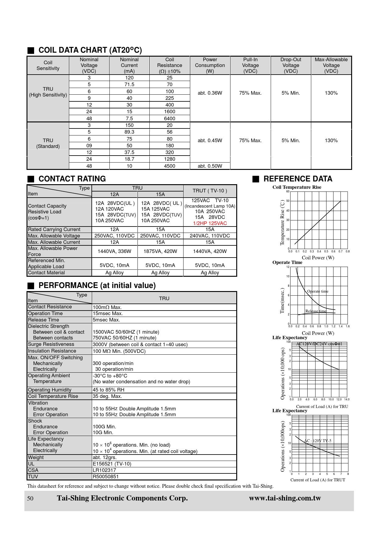

COIL DATA CHART (AT20. CONTACT RATING. REFERENCE DATA. Coil Temperature Rise. Operate Time. PERFORMANCE (at initial value)
COIL DATA CHART (AT20 CONTACT RATING REFERENCE DATA Coil Temperature Rise Operate Time PERFORMANCE (at initial value)
TRU
C)
Nominal Nominal Coil Power Pull-In Drop-Out Max-Allowable Coil Voltage Current Resistance Consumption Voltage Voltage Voltage Sensitivity (VDC) (mA) () 10% (W) (VDC) (VDC) (VDC) 3 120 25 5 71.5 70 TRU 6 60 100 (High Sensitivity) abt. 0.36W 75% Max. 5% Min. 130% 9 40 225 12 30 400 24 15 1600 48 7.5 6400 3 150 20 5 89.3 56 6 75 80 TRU abt. 0.45W 75% Max. 5% Min. 130% (Standard) 09 50 180 12 37.5 320 24 18.7 1280 48 10 4500 abt. 0.50W ▓
CONTACT RATING
REFERENCE DATA
Type TRU
TRUT ( TV-10 ) 60 Item 12A 15A 125VAC TV-10 ) 12A 28VDC(UL ) 12A 28VDC( UL ) 50 Contact Capacity (Incandescent Lamp 10A) 12A 120VAC 15A 125VAC (℃ Resistive Load 10A 250VAC 40 15A 28VDC(TUV) 15A 28VDC(TUV) ise (cos=1) 15A 28VDC R 10A 250VAC 10A 250VAC 30 1/2HP 125VAC re tu Rated Carrying Current 12A 15A 15A 20 ra e Max. Allowable Voltage 250VAC, 110VDC 250VAC, 110VDC 240VAC, 110VDC p m 10 Max. Allowable Current 12A 15A 15A e T Max. Allowable Power 0 1440VA, 336W 1875VA, 420W 1440VA, 420W 0.0 0.1 0.2 0.3 0.4 0.5 0.6 0.7 0.8 Force Coil Power (W) Referenced Min.
Operate Time
Applicable Load 5VDC, 10mA 5VDC, 10mA 5VDC, 10mA 12 Contact Material Ag Alloy Ag Alloy Ag Alloy 10 ▓
8 c.) Operate time Type 6 se Item TRU (m e Contact Resistance 4 100m Max. im Release time Operation Time 15msec Max. T 2 Release Time 5msec Max. 0 Dielectric Strength 0.0 0.2 0.4 0.6 0.8 1.0 1.2 1.4 1.6 Between coil & contact 1500VAC 50/60HZ (1 minute) Coil Power (W) Between contacts 750VAC 50/60HZ (1 minute)
Life Expectancy
100 Surge Resistiveness 3000V (between coil & contact 140 usec) AC120V/DC24V cos=1 Insulation Resistance 100 M Min. (500VDC) s) 5 p o Max. ON/OFF Switching 3 0 2 Mechanically 300 operation/min 0 ,0 Electrically 30 operation/min 0 10 1 Operating Ambient -30C to +80C ( 5 s Temperature (No water condensation and no water drop) n 3 Operating Humidity 45 to 85% RH 2 ratio e Coil Temperature Rise 35 deg. Max. p 1 O 0.0 2.0 4.0 6.0 8.0 10.0 12.0 14.0 Vibration Endurance 10 to 55HZ z Double Amplitude 1.5mm Current of Load (A) for TRU
Life Expectancy
Error Operation 10 to 55HZ z Double Amplitude 1.5mm 100 Shock s) 5 Endurance 100G Min. p o 3 Error Operation 10G Min. 0 0 2 Life Expectancy ,0 0 AC : 120V TV-5 Mechanically 10  106 operations. Min. (no load) 10 1( Electrically 10  104 operations. Min. (at rated coil voltage) s 5 n Weight abt. 12grs. 3 UL E156521 (TV-10) ratio 2 e p CSA LR102317 O 10 1 2 3 4 5 6 7 8 TUV R50050851 Current of Load (A) for TRUT This datasheet for reference and subject to change without notice. Please double check final specification with Tai-Shing. 50
