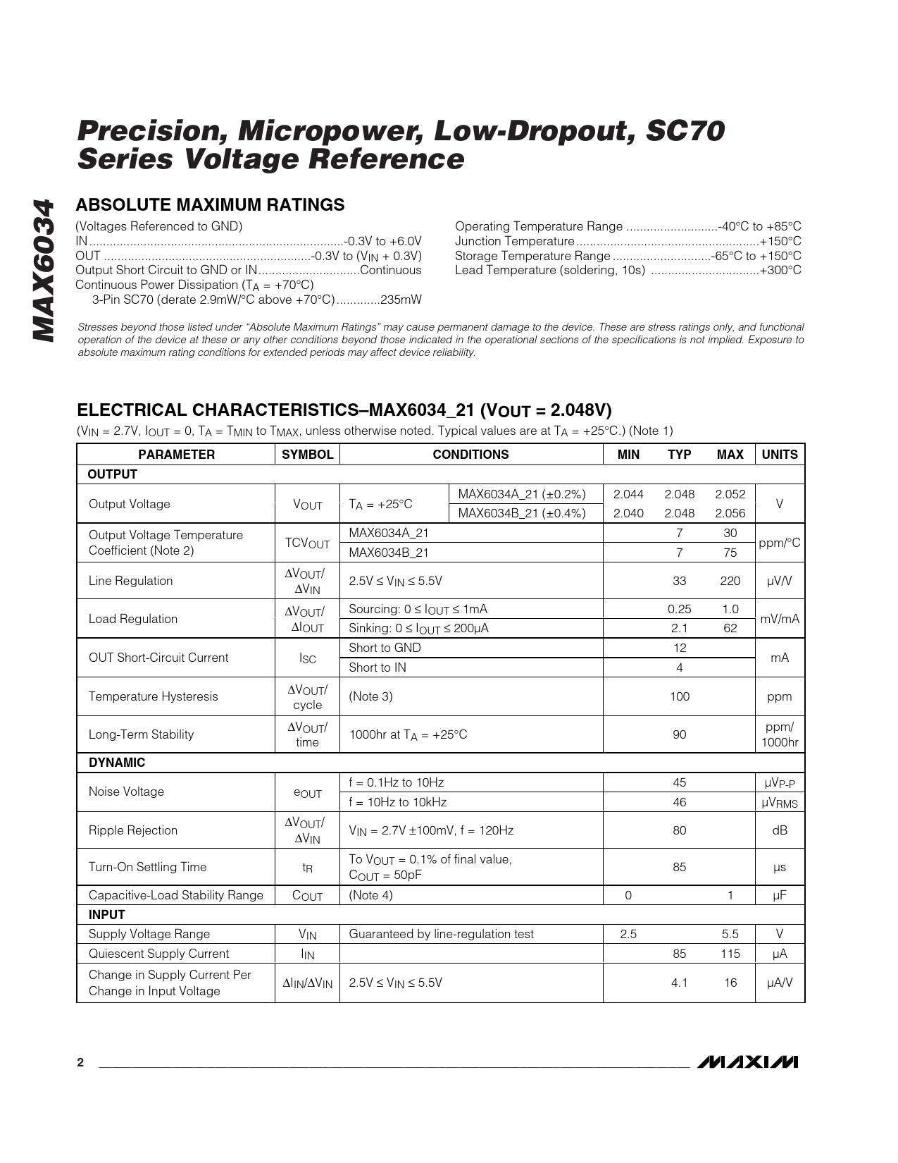

Precision, Micropower, Low-Dropout, SC70 Series Voltage Reference. ABSOLUTE MAXIMUM RATINGS. MAX6034
Precision, Micropower, Low-Dropout, SC70 Series Voltage Reference ABSOLUTE MAXIMUM RATINGS MAX6034
(Voltages Referenced to GND) Operating Temperature Range ...-40°C to +85°C IN ...-0.3V to +6.0V Junction Temperature ..+150°C OUT ...-0.3V to (VIN + 0.3V) Storage Temperature Range ...-65°C to +150°C Output Short Circuit to GND or IN..Continuous Lead Temperature (soldering, 10s) ..+300°C Continuous Power Dissipation (TA = +70°C) 3-Pin SC70 (derate 2.9mW/°C above +70°C) ...235mW
MAX6034
Stresses beyond those listed under “Absolute Maximum Ratings” may cause permanent damage to the device. These are stress ratings only, and functional operation of the device at these or any other conditions beyond those indicated in the operational sections of the specifications is not implied. Exposure to absolute maximum rating conditions for extended periods may affect device reliability.
ELECTRICAL CHARACTERISTICS–MAX6034_21 (VOUT = 2.048V)
(VIN = 2.7V, IOUT = 0, TA = TMIN to TMAX, unless otherwise noted. Typical values are at TA = +25°C.) (Note 1)
PARAMETER SYMBOL CONDITIONS MIN TYP MAX UNITS OUTPUT
MAX6034A_21 (±0.2%) 2.044 2.048 2.052 Output Voltage VOUT TA = +25°C V MAX6034B_21 (±0.4%) 2.040 2.048 2.056 Output Voltage Temperature MAX6034A_21 7 30 TCVOUT ppm/°C Coefficient (Note 2) MAX6034B_21 7 75 ∆VOUT/ Line Regulation ∆ 2.5V ≤ V V IN ≤ 5.5V 33 220 µV/V IN Sourcing: 0 ∆VOUT/ ≤ IOUT ≤ 1mA 0.25 1.0 Load Regulation ∆ mV/mA IOUT Sinking: 0 ≤ IOUT ≤ 200µA 2.1 62 Short to GND 12 OUT Short-Circuit Current ISC mA Short to IN 4 ∆V Temperature Hysteresis OUT/ (Note 3) 100 ppm cycle ∆VOUT/ ppm/ Long-Term Stability 1000hr at T time A = +25°C 90 1000hr
DYNAMIC
f = 0.1Hz to 10Hz 45 µVP-P Noise Voltage eOUT f = 10Hz to 10kHz 46 µVRMS ∆VOUT/ Ripple Rejection ∆ VIN = 2.7V ±100mV, f = 120Hz 80 dB VIN To VOUT = 0.1% of final value, Turn-On Settling Time tR 85 µs COUT = 50pF Capacitive-Load Stability Range COUT (Note 4) 0 1 µF
INPUT
Supply Voltage Range VIN Guaranteed by line-regulation test 2.5 5.5 V Quiescent Supply Current IIN 85 115 µA Change in Supply Current Per ∆IIN/∆VIN 2.5V ≤ VIN ≤ 5.5V 4.1 16 µA/V Change in Input Voltage
