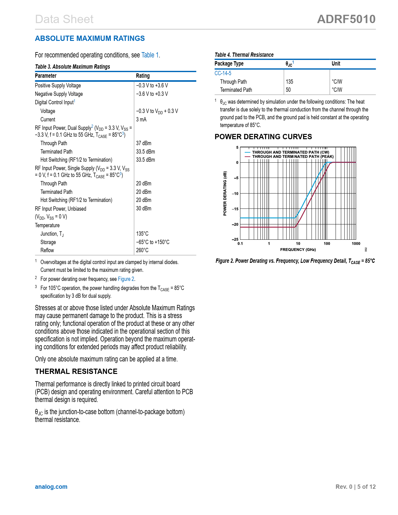

ADRF5010. ABSOLUTE MAXIMUM RATINGS. Table 4. Thermal Resistance. Table 3. Absolute Maximum Ratings. Package Type. θJC. Unit
ADRF5010 ABSOLUTE MAXIMUM RATINGS Table 4 Thermal Resistance Table 3 Absolute Maximum Ratings Package Type θJC Unit
link to page 3 link to page 5 link to page 5 link to page 5 link to page 5 link to page 5 link to page 5 link to page 12 Data Sheet
For recommended operating conditions, see Table 1.
Table 4. Thermal Resistance 1 Table 3. Absolute Maximum Ratings Package Type θJC Unit Parameter Rating
CC-14-5 Through Path 135 °C/W Positive Supply Voltage −0.3 V to +3.6 V Terminated Path 50 °C/W Negative Supply Voltage −3.6 V to +0.3 V Digital Control Input1 1 θJC was determined by simulation under the following conditions: The heat Voltage −0.3 V to V transfer is due solely to the thermal conduction from the channel through the DD + 0.3 V Current 3 mA ground pad to the PCB, and the ground pad is held constant at the operating RF Input Power, Dual Supply2 (V temperature of 85°C. DD = 3.3 V, VSS = −3.3 V, f = 0.1 GHz to 55 GHz, TCASE = 85°C3)
POWER DERATING CURVES
Through Path 37 dBm Terminated Path 33.5 dBm Hot Switching (RF1/2 to Termination) 33.5 dBm RF Input Power, Single Supply (VDD = 3.3 V, VSS = 0 V, f = 0.1 GHz to 55 GHz, TCASE = 85°C3) Through Path 20 dBm Terminated Path 20 dBm Hot Switching (RF1/2 to Termination) 20 dBm RF Input Power, Unbiased 30 dBm (VDD, VSS = 0 V) Temperature Junction, TJ 135°C Storage −65°C to +150°C Reflow 260°C 1 Overvoltages at the digital control input are clamped by internal diodes.
Figure 2. Power Derating vs. Frequency, Low Frequency Detail, TCASE = 85°C
Current must be limited to the maximum rating given. 2 For power derating over frequency, see Figure 2. 3 For 105°C operation, the power handling degrades from the TCASE = 85°C specification by 3 dB for dual supply. Stresses at or above those listed under Absolute Maximum Ratings may cause permanent damage to the product. This is a stress rating only; functional operation of the product at these or any other conditions above those indicated in the operational section of this specification is not implied. Operation beyond the maximum operat- ing conditions for extended periods may affect product reliability. Only one absolute maximum rating can be applied at a time.
THERMAL RESISTANCE
Thermal performance is directly linked to printed circuit board (PCB) design and operating environment. Careful attention to PCB thermal design is required. θJC is the junction-to-case bottom (channel-to-package bottom) thermal resistance.
