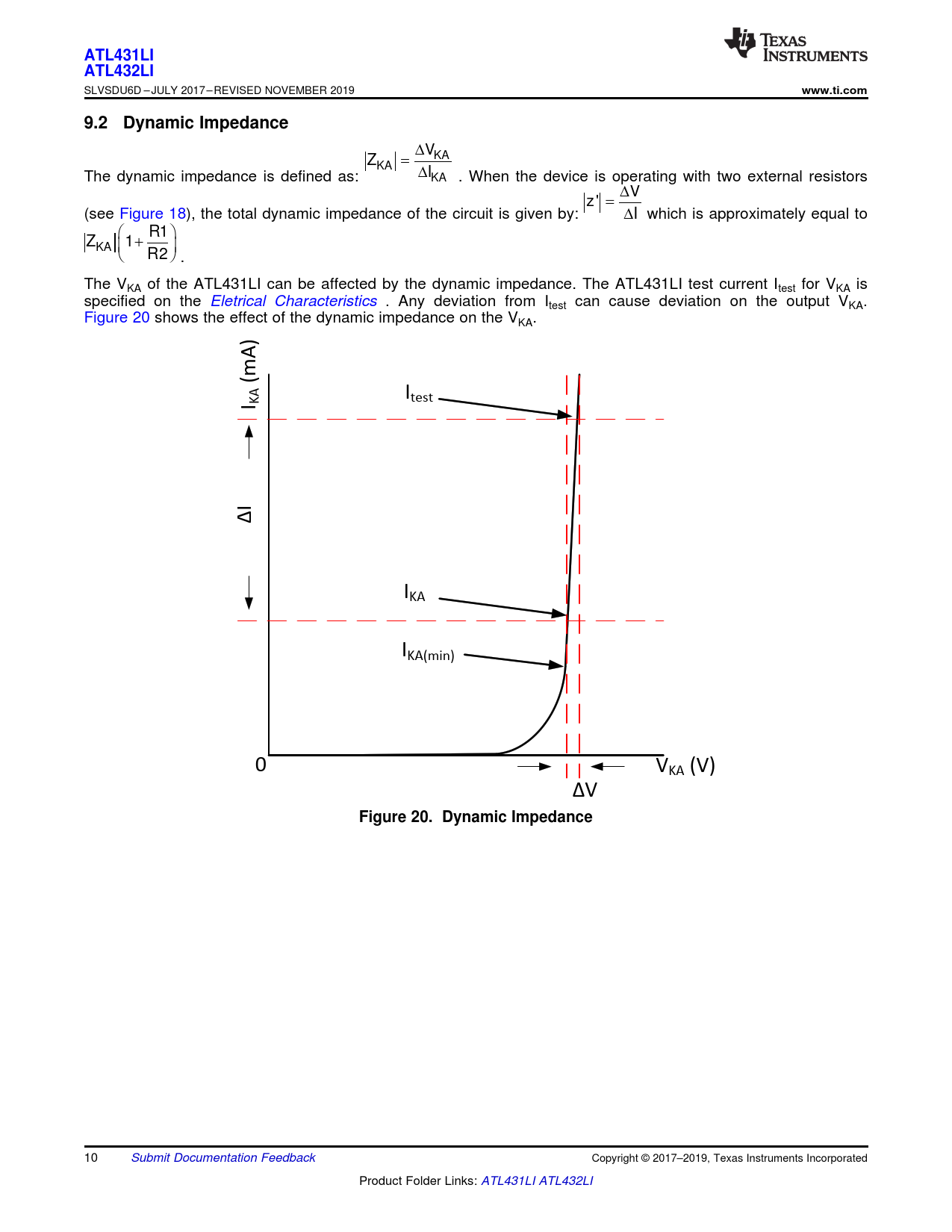

www.ti.com 9.2 Dynamic Impedance
' K V A K Z A The dynamic impedance is defined as: ' K I A . When the device is operating with two external resistors 'V z' (see Figure 18), the total dynamic impedance of the circuit is given by: 'I which is approximately equal to § R1 · K Z A ¨1 ¸ © R2 ¹ . The VKA of the ATL431LI can be affected by the dynamic impedance. The ATL431LI test current Itest for VKA is specified on the Eletrical Characteristics . Any deviation from Itest can cause deviation on the output VKA. Figure 20 shows the effect of the dynamic impedance on the VKA. ) A (m A I I K test / P IKA IKA(min) 0 VKA (V) Ps
Figure 20. Dynamic Impedance
