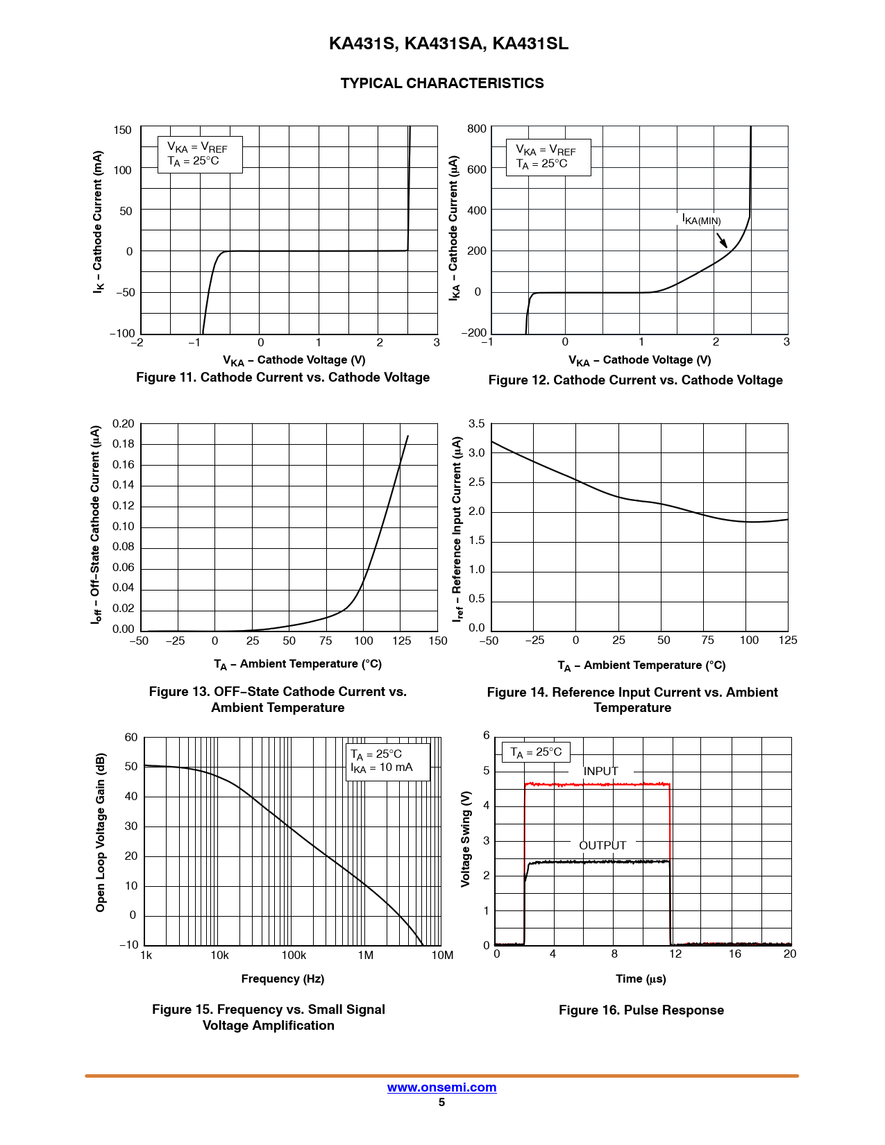

Datasheet KA431SA (ON Semiconductor) - 5
ManufacturerON Semiconductor
DescriptionAdjustable/2.5 V, 1% Tolerance Shunt Regulator
Pages / Page8 / 5 — KA431S, KA431SA, KA431SL. TYPICAL CHARACTERISTICS. mA). − Cathode Current …
File Format / SizePDF / 205 Kb
KA431S, KA431SA, KA431SL. TYPICAL CHARACTERISTICS. mA). − Cathode Current (mA). − Cathode Current (. I K. I KA
KA431S, KA431SA, KA431SL TYPICAL CHARACTERISTICS mA) − Cathode Current (mA) − Cathode Current ( I K I KA

VKA − Cathode Voltage (V) VKA − Cathode Voltage (V) Figure 11. Cathode Current vs. Cathode Voltage Figure 12. Cathode Current vs. Cathode Voltage

C) Figure 13. OFF−State Cathode Current vs. Figure 14. Reference Input Current vs. Ambient Ambient Temperature Temperature

Frequency (Hz) Time (ms) Figure 15. Frequency vs. Small Signal Figure 16. Pulse Response Voltage Amplification www.onsemi.com 5
