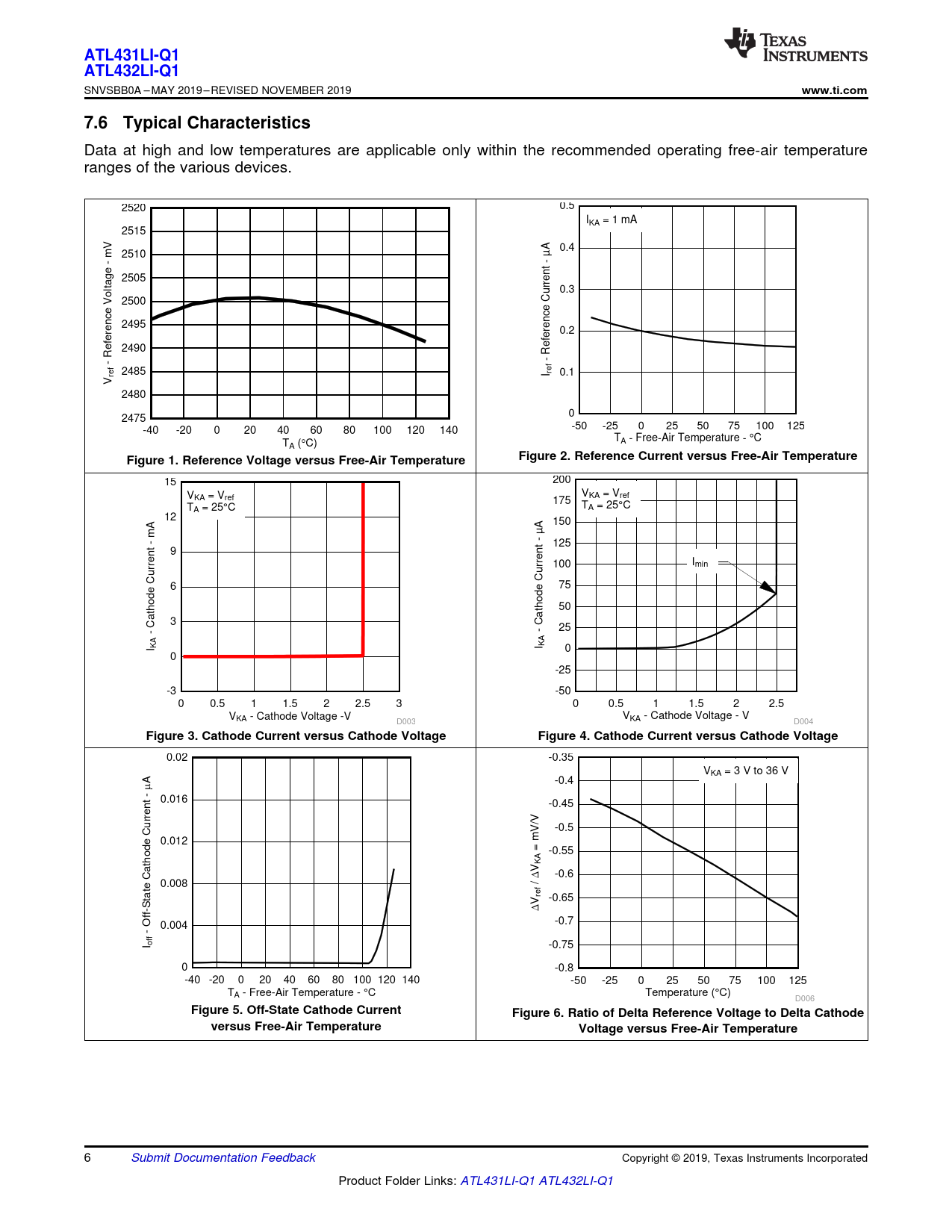

ATL431LI-Q1. ATL432LI-Q1. www.ti.com. 7.6 Typical Characteristics. Figure 1. Reference Voltage versus Free-Air Temperature
ATL431LI-Q1 ATL432LI-Q1 www.ti.com 7.6 Typical Characteristics Figure 1 Reference Voltage versus Free-Air Temperature
SNVSBB0A – MAY 2019 – REVISED NOVEMBER 2019
Data at high and low temperatures are applicable only within the recommended operating free-air temperature ranges of the various devices. 2520 0.5 IKA = 1 mA 2515 A 0.4 mV 2510 µ - e t - 2505 ren ltag 0.3 Cur Vo 2500 ce ce 2495 ren 0.2 e eren ef 2490 ef - R - R f f re 2485 I re 0.1 V 2480 2475 0 -40 -20 0 20 40 60 80 100 120 140 -50 -25 0 25 50 75 100 125 T TA - Free-Air Temperature - °C A (qC)
Figure 1. Reference Voltage versus Free-Air Temperature Figure 2. Reference Current versus Free-Air Temperature
15 200 V V KA = Vref 175 KA = Vref T T A = 25°C A = 25°C 12 A 150 - µ t - mA 125 9 en ent I urr 100 min e Curr 6 75 de C od 50 ath atho 3 25 - C - C A A I K I K 0 0 -25 -3 -50 0 0.5 1 1.5 2 2.5 3 0 0.5 1 1.5 2 2.5 VKA - Cathode Voltage -V V D003 KA - Cathode Voltage - V D004
Figure 3. Cathode Current versus Cathode Voltage Figure 4. Cathode Current versus Cathode Voltage
0.02 -0.35 VKA = 3 V to 36 V A -0.4 P t - 0.016 -0.45 ren V/V -0.5 e Cur 0.012 m = -0.55 A KV -0.6 0.008 / ' freV -0.65 -State Cathod ' -0.7 0.004 - Off I off -0.75 0 -0.8 -40 -20 0 20 40 60 80 100 120 140 -50 -25 0 25 50 75 100 125 TA - Free-Air Temperature - °C Temperature (°C) D006
Figure 5. Off-State Cathode Current Figure 6. Ratio of Delta Reference Voltage to Delta Cathode versus Free-Air Temperature Voltage versus Free-Air Temperature
