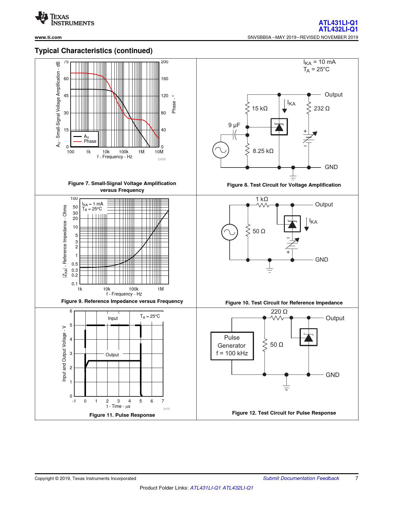

ATL431LI-Q1. ATL432LI-Q1. www.ti.com. Typical Characteristics (continued). Figure 7. Small-Signal Voltage Amplification
ATL431LI-Q1 ATL432LI-Q1 www.ti.com Typical Characteristics (continued) Figure 7 Small-Signal Voltage Amplification
SNVSBB0A – MAY 2019 – REVISED NOVEMBER 2019
75 200 IKA = 10 mA - dB TA = 25°C on ti 60 160 ica lif mp A 45 120 Output q IKA oltage 15 kΩ 232 Ω Phase - 30 80 al V gn 9 µF 15 40 + AV - Small-Si V Phase A 0 0 − 100 1k 10k 100k 1M 10M 8.25 kΩ f - Frequency - Hz D000 GND
Figure 7. Small-Signal Voltage Amplification Figure 8. Test Circuit for Voltage Amplification versus Frequency
100 1 kΩ I Output 50 KA = 1 mA ms TA = 25°C Oh 30 - 20 e I c KA an 10 d 50 Ω pe 5 − Im 3 ce 2 ren + e 1 ef GND - R 0.5 | A 0.3 K|Z 0.2 0.1 1k 10k 100k 1M f - Frequency - Hz
Figure 9. Reference Impedance versus Frequency Figure 10. Test Circuit for Reference Impedance
6 220 Ω T Input A = 25qC Output 5 - V ge 4 Pulse olta Generator 50 Ω t V pu 3 Output f = 100 kHz d Out 2 ut an GND Inp 1 0 -1 0 1 2 3 4 5 6 7 t - Time - Ps puls
Figure 11. Pulse Response Figure 12. Test Circuit for Pulse Response
