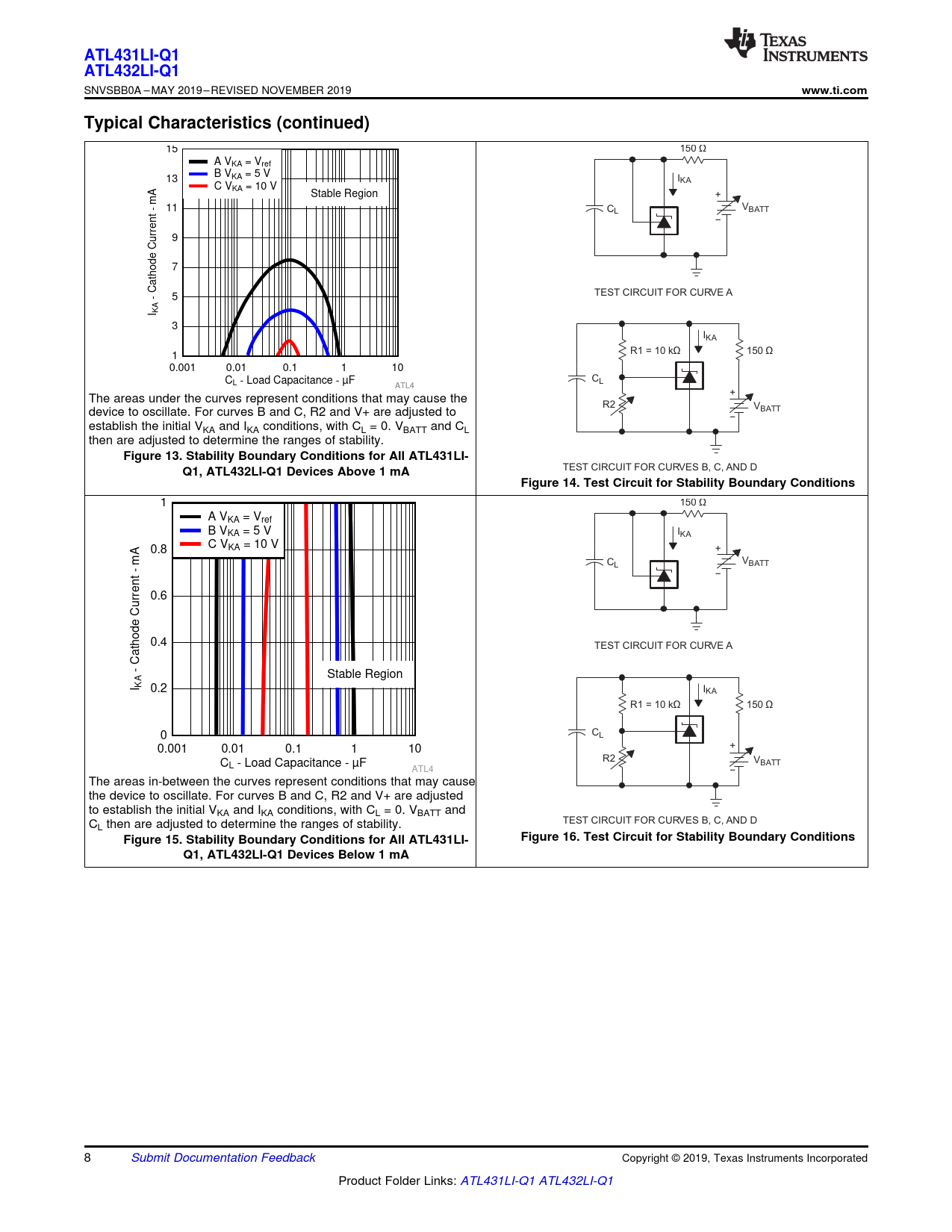

www.ti.com Typical Characteristics (continued)
15 150 Ω A VKA = Vref 13 B VKA = 5 V IKA C VKA = 10 V Stable Region + 11 C V L BATT t - mA − en 9 e Curr od 7 ath TEST CIRCUIT FOR CURVE A - C 5 AIK 3 IKA R1 = 10 kΩ 150 Ω 1 0.001 0.01 0.1 1 10 C C L L - Load Capacitance - µF AT A L4 + The areas under the curves represent conditions that may cause the R2 VBATT device to oscillate. For curves B and C, R2 and V+ are adjusted to − establish the initial VKA and IKA conditions, with CL = 0. VBATT and CL then are adjusted to determine the ranges of stability.
Figure 13. Stability Boundary Conditions for All ATL431LI-
TEST CIRCUIT FOR CURVES B, C, AND D
Q1, ATL432LI-Q1 Devices Above 1 mA Figure 14. Test Circuit for Stability Boundary Conditions
150 Ω 1 A VKA = Vref B V I KA = 5 V KA C VKA = 10 V + 0.8 C V L BATT − t - mA en 0.6 e Curr od 0.4 TEST CIRCUIT FOR CURVE A ath - C A Stable Region I K 0.2 IKA R1 = 10 kΩ 150 Ω CL 0 + 0.001 0.01 0.1 1 10 R2 VBATT CL - Load Capacitance - µF ATL4 − The areas in-between the curves represent conditions that may cause the device to oscillate. For curves B and C, R2 and V+ are adjusted to establish the initial VKA and IKA conditions, with CL = 0. VBATT and TEST CIRCUIT FOR CURVES B, C, AND D CL then are adjusted to determine the ranges of stability.
Figure 15. Stability Boundary Conditions for All ATL431LI- Figure 16. Test Circuit for Stability Boundary Conditions Q1, ATL432LI-Q1 Devices Below 1 mA
