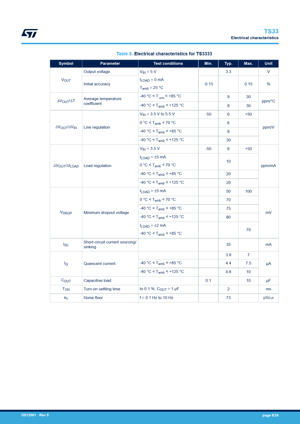

TS33. Electrical characteristics. Table 8. Electrical characteristics for TS3333. Symbol. Parameter. Test conditions. Min. Typ. Max. Unit
TS33 Electrical characteristics Table 8 Electrical characteristics for TS3333 Symbol Parameter Test conditions Min Typ Max Unit
TS33 Electrical characteristics Table 8. Electrical characteristics for TS3333 Symbol Parameter Test conditions Min. Typ. Max. Unit
Output voltage VIN = 5 V 3.3 V VOUT ILOAD = 0 mA Initial accuracy -0.15 0.15 % Tamb = 25 °C -40 °C < T amb < +85 °C 9 30 ∆VOUT/∆T Average temperature ppm/°C coefficient -40 °C < Tamb < +125 °C 8 30 VIN = 3.5 V to 5.5 V -50 6 +50 0 °C < Tamb < 70 °C 6 ∆VOUT/∆VIN Line regulation ppm/V -40 °C < Tamb < +85 °C 8 -40 °C < Tamb < +125 °C 30 VIN = 3.5 V -50 6 +50 ILOAD = ±5 mA 10 ∆VOUT/∆ILOAD Load regulation 0 °C < Tamb < 70 °C ppm/mA -40 °C < Tamb < +85 °C 20 -40 °C < Tamb < +125 °C 20 ILOAD = ±5 mA 50 100 0 °C < Tamb < 70 °C 70 -40 °C < Tamb < +85 °C 75 VDROP Minimum dropout voltage mV -40 °C < Tamb < +125 °C 80 ILOAD = ±2 mA 70 -40 °C < Tamb < +85 °C I Short-circuit current sourcing/ SC 35 mA sinking 3.9 7 IQ Quiescent current -40 °C < Tamb < +85 °C 4.4 7.5 µA -40 °C < Tamb < +125 °C 4.8 10 COUT Capacitive load 0.1 10 µF TON Turn-on settling time to 0.1 %, COUT = 1 µF 2 ms en Noise floor f = 0.1 Hz to 10 Hz 73 µVP-P
