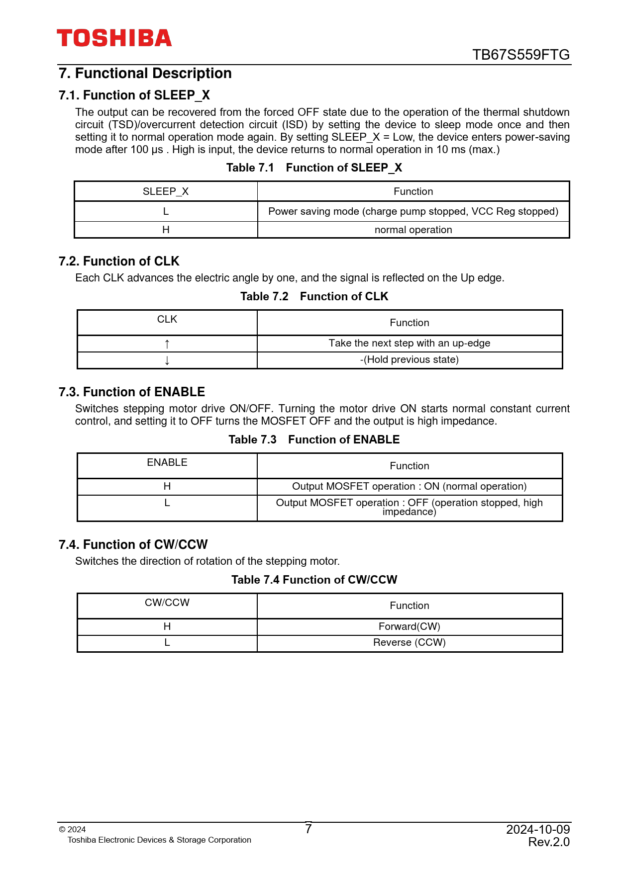

TB67S559FTG
7. Functional Description 7.1. Function of SLEEP_X
The output can be recovered from the forced OFF state due to the operation of the thermal shutdown circuit (TSD)/overcurrent detection circuit (ISD) by setting the device to sleep mode once and then setting it to normal operation mode again. By setting SLEEP_X = Low, the device enters power-saving mode after 100 μs . High is input, the device returns to normal operation in 10 ms (max.)
Table 7.1 Function of SLEEP_X
SLEEP_X Function L Power saving mode (charge pump stopped, VCC Reg stopped) H normal operation
7.2. Function of CLK
Each CLK advances the electric angle by one, and the signal is reflected on the Up edge.
Table 7.2 Function of CLK
CLK Function ↑ Take the next step with an up-edge ↓ -(Hold previous state)
7.3. Function of ENABLE
Switches stepping motor drive ON/OFF. Turning the motor drive ON starts normal constant current control, and setting it to OFF turns the MOSFET OFF and the output is high impedance.
Table 7.3 Function of ENABLE
ENABLE Function H Output MOSFET operation : ON (normal operation) L Output MOSFET operation : OFF (operation stopped, high impedance)
7.4. Function of CW/CCW
Switches the direction of rotation of the stepping motor.
Table 7.4 Function of CW/CCW
CW/CCW Function H Forward(CW) L Reverse (CCW) © 2 024 7 2024-10-09 Toshiba Electronic Devices & Storage Corporation Rev.2.0 Document Outline BiCD constant-current 2-phase bipolar stepping motor driver IC 1. Description 2. Features 3. Pin assignment 4. Block diagram 5. Pin Description 6. Input / Output Equivalent Circuit 7. Functional Description 7.1. Function of SLEEP_X 7.2. Function of CLK 7.3. Function of ENABLE 7.4. Function of CW/CCW 7.5. Function of DMODE0, DMODE1,DMODE2 7.6. Sequence by drive mode in clock input control mode 7.7. Excitation method and set current value 7.8. Selectable Mixed Decay Function 7.9. Mixed Decay current waveform 1 7.10. For each time of constant-current PWM operation 7.11. Mixed Decay current waveform 2 7.12. ADMD (Advanced Dynamic Mixed Decay) Constant current control 7.13. ADMD (Advanced Dynamic Mixed Decay) current waveform 1 7.14. ADMD (Advanced Dynamic Mixed Decay) current waveform 2 7.15. Function of RESET 7.16. Torque Function 7.17. Function of MO 7.18. LO (error detection flag output) Function 8. Output stage transistor operation mode (Advanced Dynamic Mixed Decay) 8.1. Functions of output stage transistor operation 9. About the set current value (IOUT) 10. About chopping frequency (fCHOP) 11. Power Consumption of IC 11.1. Power consumption of power transistor section 11.2. Power consumption of logic and IM systems 11.3. Power consumption 12. About the detection function 13. Overheat detection (This function is a latch type that maintains operation at the time of detection.) 14. Overcurrent detection (This function is a latch type that maintains operation at the time of detection.) 15. Absolute Maximum Ratings (Ta = 25 C) 16. PD-Ta graph (for reference) 17. Operating range (Ta = -40 to 85 C) 18. Electrical Specifications 18.1. Electrical Specifications 1(Ta = 25 C, VM = 24 V unless otherwise specified) 18.2. Electrical Specifications 2 (Ta = 25 C, VM = 24 V unless otherwise specified) 18.2.1. With respect to back EMF 18.2.2. Overcurrent and overheat detection 18.2.3. Handling of ICs 19. AC electrical characteristics (Ta = 25 C, VM = 24V) 20. AC Characteristics Timing Chart 21. Application Circuit Example 22. Package Information 23. Notes on Contents 24. IC Usage Considerations 24.1. Notes on Handling of ICs 24.2. Points to Remember on Handling of ICs RESTRICTIONS ON PRODUCT USE
