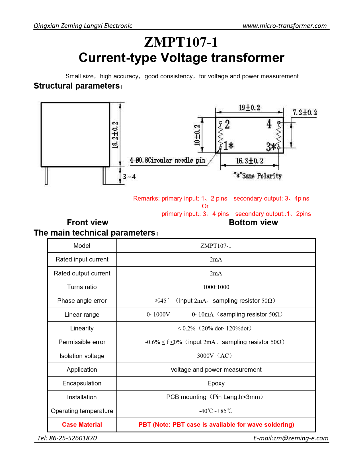

ZMPT107-1. Current-type Voltage transformer. Structural parameters. Front view. Bottom view. The main technical parameters
Datasheet ZMPT107-1 Qingxian Zeming Langxi Electronic
Qingxian Zeming Langxi Electronic www.micro-transformer.com
ZMPT107-1 Current-type Voltage transformer
Smal size,high accuracy,good consistency,for voltage and power measurement
: Remarks: primary input: 1、2 pins secondary output: 3、4pins Or primary input:: 3、4 pins secondary output::1、2pins
Front view Bottom view The main technical parameters
: Model ZMPT107-1 Rated input current 2mA Rated output current 2mA Turns ratio 1000:1000 Phase angle error ≤45'(input 2mA,sampling resistor 50Ω) Linear range 0~1000V 0~10mA(sampling resistor 50Ω) Linearity ≤ 0.2%(20% dot~120%dot) Permissible error -0.6% ≤ f ≤0%(input 2mA,sampling resistor 50Ω) Isolation voltage 3000V(AC) Application voltage and power measurement Encapsulation Epoxy Instal ation PCB mounting(Pin Length>3mm) Operating temperature -40℃~+85℃
Case Material PBT (Note: PBT case is available for wave soldering)
