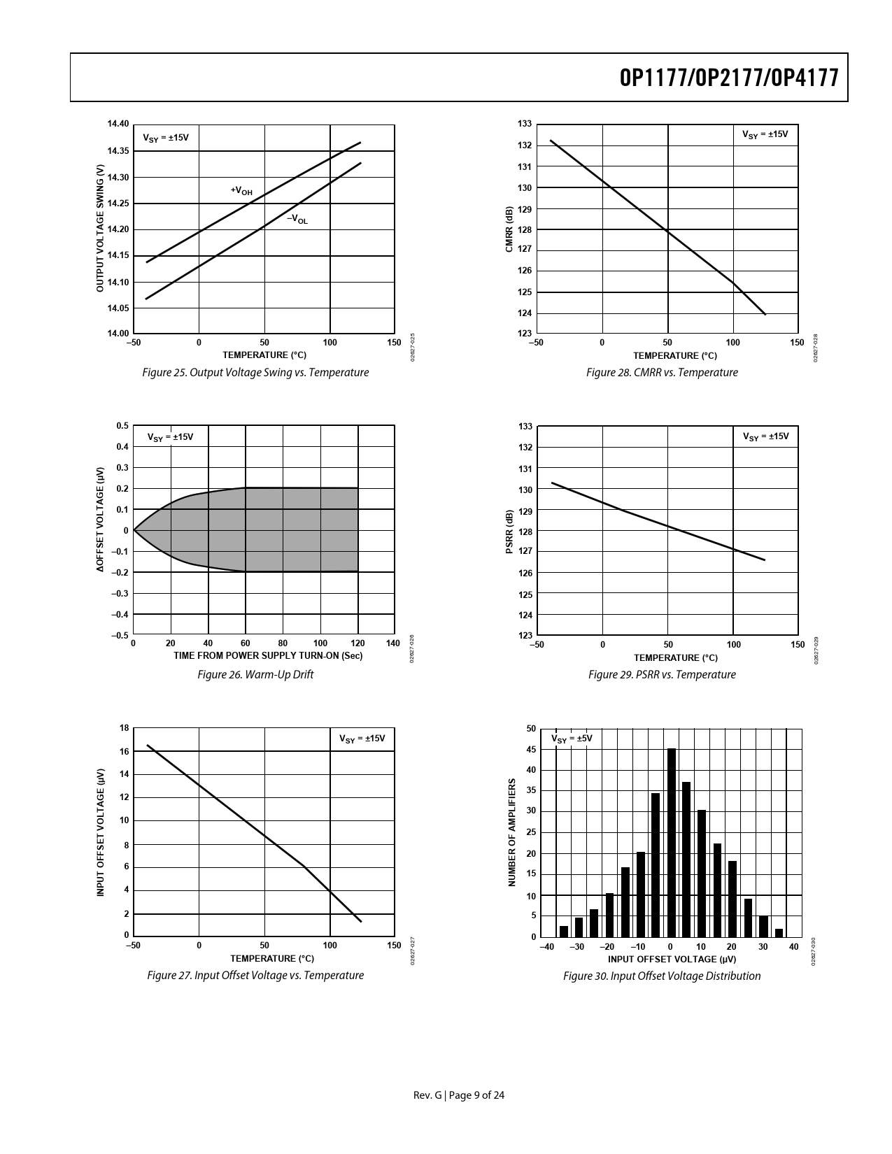

02 26 0 Figure 25. Output Voltage Swing vs. Temperature Figure 28. CMRR vs. Temperature

62 02 02 Figure 26. Warm-Up Drift Figure 29. PSRR vs. Temperature

02 262 0 Figure 27. Input Offset Voltage vs. Temperature Figure 30. Input Offset Voltage Distribution Rev. G | Page 9 of 24 Document Outline FEATURES APPLICATIONS PIN CONFIGURATIONS GENERAL DESCRIPTION TABLE OF CONTENTS REVISION HISTORY SPECIFICATIONS ELECTRICAL CHARACTERISTICS ELECTRICAL CHARACTERISTICS ABSOLUTE MAXIMUM RATINGS THERMAL RESISTANCE ESD CAUTION TYPICAL PERFORMANCE CHARACTERISTICS FUNCTIONAL DESCRIPTION TOTAL NOISE-INCLUDING SOURCE RESISTORS GAIN LINEARITY INPUT OVERVOLTAGE PROTECTION OUTPUT PHASE REVERSAL SETTLING TIME OVERLOAD RECOVERY TIME THD + NOISE CAPACITIVE LOAD DRIVE STRAY INPUT CAPACITANCE COMPENSATION REDUCING ELECTROMAGNETIC INTERFERENCE PROPER BOARD LAYOUT DIFFERENCE AMPLIFIERS A HIGH ACCURACY THERMOCOUPLE AMPLIFIER LOW POWER LINEARIZED RTD SINGLE OPERATIONAL AMPLIFIER BRIDGE REALIZATION OF ACTIVE FILTERS BAND-PASS KRC OR SALLEN-KEY FILTER CHANNEL SEPARATION REFERENCES ON NOISE DYNAMICS AND FLICKER NOISE OUTLINE DIMENSIONS ORDERING GUIDE
