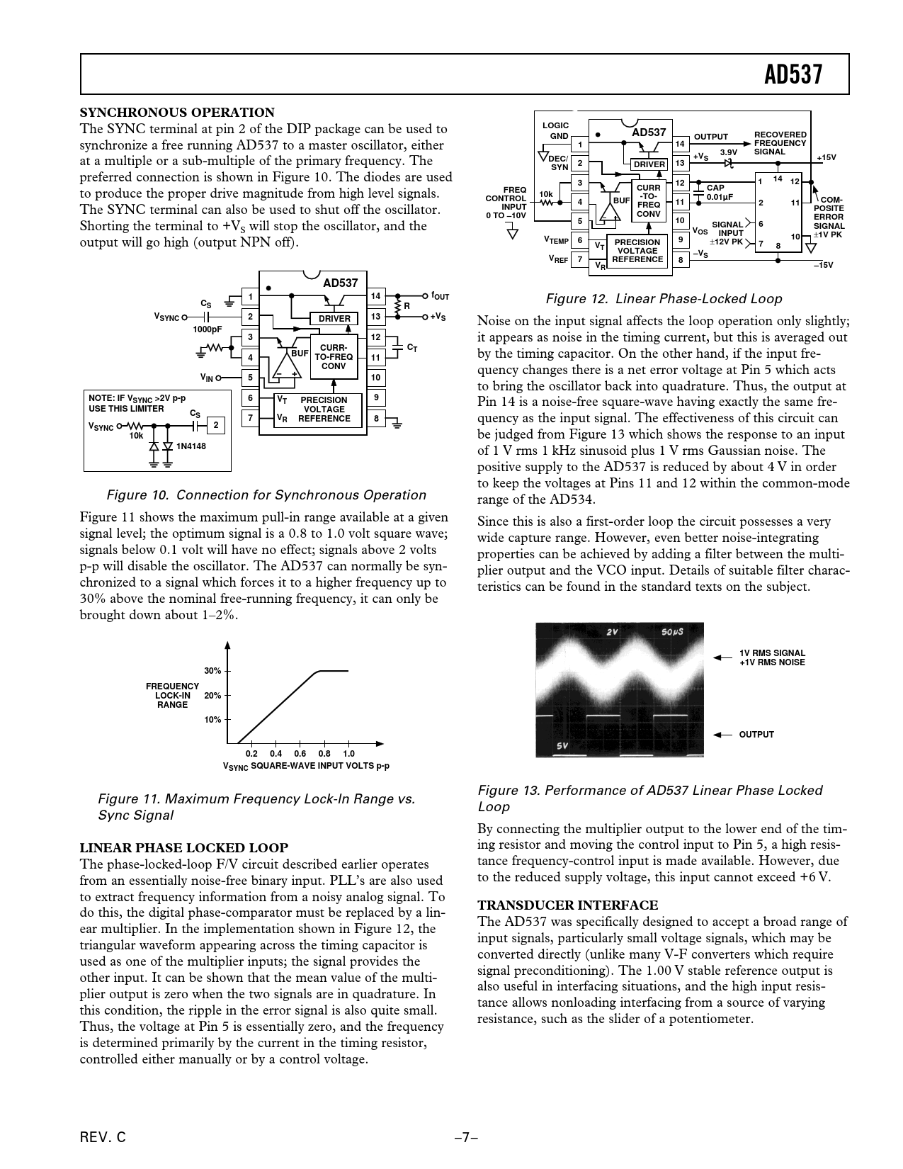

AD537. SYNCHRONOUS OPERATION. LOGIC. GND. OUTPUT. RECOVERED. FREQUENCY. 3.9V. SIGNAL. DEC/. +15V. DRIVER. SYN. CURR. CAP. FREQ. 10k. -TO-. 0.01µF. CONTROL. BUF
AD537 SYNCHRONOUS OPERATION LOGIC GND OUTPUT RECOVERED FREQUENCY 3.9V SIGNAL DEC/ +15V DRIVER SYN CURR CAP FREQ 10k -TO- 0.01µF CONTROL BUF
The SYNC terminal at pin 2 of the DIP package can be used to
LOGIC AD537 GND OUTPUT RECOVERED
synchronize a free running AD537 to a master oscillator, either
1 14 FREQUENCY 3.9V SIGNAL
at a multiple or a sub-multiple of the primary frequency. The
+V DEC/ S +15V 2 DRIVER 13 SYN
preferred connection is shown in Figure 10. The diodes are used
14 3 12 1 12
to produce the proper drive magnitude from high level signals.
CURR CAP FREQ 10k -TO- 0.01µF CONTROL 4 BUF 11 2 11 COM-
The SYNC terminal can also be used to shut off the oscillator.
INPUT FREQ POSITE 0 TO –10V CONV ERROR
Shorting the terminal to +V
5 10 SIGNAL 6
S will stop the oscillator, and the
SIGNAL VOS INPUT
1V PK
output will go high (output NPN off).
10 VTEMP 6 9 PRECISION
12V PK V 7 8 T VOLTAGE –VS VREF 7 REFERENCE 8 V –15V R AD537 1 14 fOUT
Figure 12. Linear Phase-Locked Loop
CS R VSYNC 2 13 +V DRIVER S
Noise on the input signal affects the loop operation only slightly;
1000pF 3 12
it appears as noise in the timing current, but this is averaged out
CURR- CT BUF
by the timing capacitor. On the other hand, if the input fre-
4 TO-FREQ 11 CONV
quency changes there is a net error voltage at Pin 5 which acts
VIN 5 10
to bring the oscillator back into quadrature. Thus, the output at
NOTE: IF V 6 9 SYNC >2V p-p VT PRECISION
Pin 14 is a noise-free square-wave having exactly the same fre-
USE THIS LIMITER C VOLTAGE S 7 VR REFERENCE 8
quency as the input signal. The effectiveness of this circuit can
V 2 SYNC 10k
be judged from Figure 13 which shows the response to an input
1N4148
of 1 V rms 1 kHz sinusoid plus 1 V rms Gaussian noise. The positive supply to the AD537 is reduced by about 4 V in order to keep the voltages at Pins 11 and 12 within the common-mode Figure 10. Connection for Synchronous Operation range of the AD534. Figure 11 shows the maximum pull-in range available at a given Since this is also a first-order loop the circuit possesses a very signal level; the optimum signal is a 0.8 to 1.0 volt square wave; wide capture range. However, even better noise-integrating signals below 0.1 volt will have no effect; signals above 2 volts properties can be achieved by adding a filter between the multi- p-p will disable the oscillator. The AD537 can normally be syn- plier output and the VCO input. Details of suitable filter charac- chronized to a signal which forces it to a higher frequency up to teristics can be found in the standard texts on the subject. 30% above the nominal free-running frequency, it can only be brought down about 1–2%.
1V RMS SIGNAL +1V RMS NOISE 30% FREQUENCY LOCK-IN 20% RANGE 10% OUTPUT 0.2 0.4 0.6 0.8 1.0 VSYNC SQUARE-WAVE INPUT VOLTS p-p
Figure 13. Performance of AD537 Linear Phase Locked Figure 11. Maximum Frequency Lock-ln Range vs. Loop Sync Signal By connecting the multiplier output to the lower end of the tim-
LINEAR PHASE LOCKED LOOP
ing resistor and moving the control input to Pin 5, a high resis- The phase-locked-loop F/V circuit described earlier operates tance frequency-control input is made available. However, due from an essentially noise-free binary input. PLL’s are also used to the reduced supply voltage, this input cannot exceed +6 V. to extract frequency information from a noisy analog signal. To
