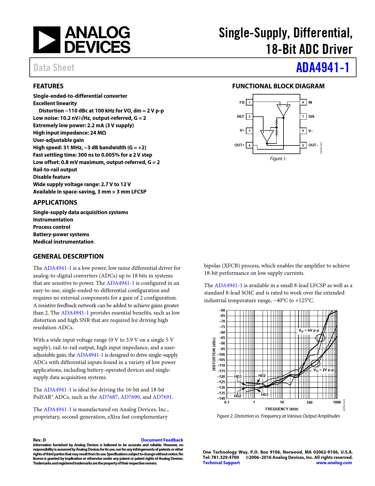

Single-Supply, Differential, 18-Bit ADC Driver Data Sheet ADA4941-1 FEATURES FUNCTIONAL BLOCK DIAGRAM Single-ended-to-differential converter Excellent linearity FB 1 8 IN Distortion −110 dBc at 100 kHz for VO, dm = 2 V p-p Low noise: 10.2 nV/√Hz, output-referred, G = 2 REF 2 7 DIS Extremely low power: 2.2 mA (3 V supply) V+ 3 6 High input impedance: 24 MΩ V– User-adjustable gain OUT+ 4 5 OUT–

The ADA4941-1 is a low power, low noise differential driver for bipolar (XFCB) process, which enables the amplifier to achieve analog-to-digital converters (ADCs) up to 18 bits in systems 18-bit performance on low supply currents. that are sensitive to power. The ADA4941-1 is configured in an The ADA4941-1 is available in a small 8-lead LFCSP as well as a easy-to-use, single-ended-to-differential configuration and standard 8-lead SOIC and is rated to work over the extended requires no external components for a gain of 2 configuration. industrial temperature range, −40°C to +125°C. A resistive feedback network can be added to achieve gains greater
–60
than 2. The ADA4941-1 provides essential benefits, such as low
–65
distortion and high SNR that are required for driving high
–70
resolution ADCs.
–75 VO = 6V p-p –80
With a wide input voltage range (0 V to 3.9 V on a single 5 V
–85 Bc) d –90
supply), rail-to-rail output, high input impedance, and a user-
( N –95
adjustable gain, the ADA4941-1 is designed to drive single-supply
IO T –100 R –105
ADCs with differential inputs found in a variety of low power
O T S –110
applications, including battery-operated devices and single-
DI V –115 O = 2V p-p
supply data acquisition systems.
–120 HD3 HD2 –125
The ADA4941-1 is ideal for driving the 16-bit and 18-bit
–130 –135
PulSAR® ADCs, such as the AD7687, AD7690, and AD7691.
HD2 HD3 –140
5
0.1 1 10 100 1000
044- The ADA4941-1 is manufactured on Analog Devices, Inc.,
FREQUENCY (kHz)
70 05 proprietary, second-generation, eXtra fast complementary Figure 2. Distortion vs. Frequency at Various Output Amplitudes
