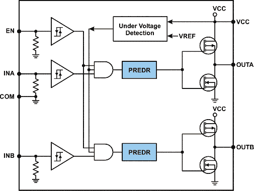

 The AUIRB24427S Functional Block Diagram
