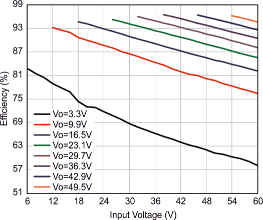

AL8862 Typical Applications Circuit   Efficiency vs. Input Voltage (RSET = 0.15 Ω, L = 68 μH)
AL8862 Typical Applications Circuit.   Efficiency vs. Input Voltage (RSET = 0.15 Ω, L = 68 μH).
