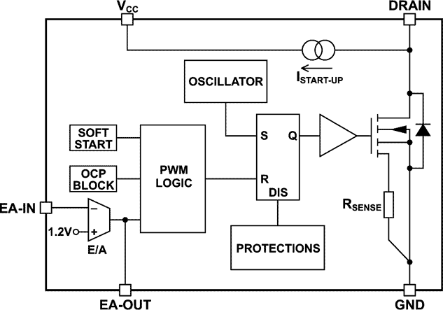

With integrated features including an error amplifier, current-sensing MOSFET, and high-voltage startup circuitry, the VIPer222 can be used in a wide variety of popular converter topologies. These include non-isolated flyback converters, isolated flyback converters with primary-side regulation or secondary-side regulation using a photo-coupler, buck converters, and buck-boost converters.
The VIPer222 is the first in ST’s highly integrated controller family to contain a 730 V avalanche-rugged power stage, ensuring superior reliability. Short-circuit protection, thermal protection, pulse skipping protection, soft start, and circuitry to manage burst-mode operation for enhanced efficiency at light load are also provided.
The VIPer222XSTR Block diagram
The VIPer222XSTR Block diagram.
Further features minimize external BoM and simplify converter design. These include a wide operating voltage (VCC) range of 4.5 V-30 V, which allows the device to be easily powered whatever the desired output voltage. The low startup voltage of 30 V DC permits a wide input-voltage range and eases starting at low supply voltages. Light-load power consumption of less than 40 mW simplifies meeting eco-design guidelines, and the jittered PWM controller allows the use of small filter components.
