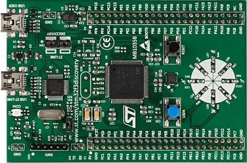

The STM32F3DISCOVERY helps you to discover the STM32 F3 series Cortex-M4 mixed-signals features and to develop your applications easily.
Detailed Description
It includes everything required for beginners and experienced users to get started quickly.
Based on the STM32F303VCT6, it includes an ST-LINK/V2 embedded debug tool, accelerometer, gyroscope and e-compass ST MEMs, USB connection, LEDs and pushbuttons.
Discovery kit STMicroelectronics STM32F3DISCOVERY
A large number of free ready-to-run application firmware examples are available on www.st.com/stm32f3discovery to support quick evaluation and development.
Key Features
  • STM32F303VCT6 microcontroller featuring 256 KB Flash, 48 KB RAM in an LQFP100 package
  • On-board ST-LINK/V2 with selection mode switch to use the kit as a standalone ST-LINK/V2 (with SWD connector for programming and debugging)
  • Board power supply: through USB bus or from an external 3 V or 5 V supply voltage
  • External application power supply: 3 V and 5 V
  • L3GD20, ST MEMs motion sensor, 3-axis digital output gyroscope
  • LSM303DLHC, ST MEMs system-in-package featuring a 3D digital linear acceleration sensor and a 3D digital magnetic sensor
  • Ten LEDs:
  • LD1 (red) for 3.3 V power on
  • LD2 (red/green) for USB communication
  • Eight user LEDS, LD3/10 (red), LD4/9 (blue), LD5/8 (orange) and LD6/7 (green)
  • Two pushbuttons (user and reset)
  • USB USER with Mini-B connector
  • Extension header for all LQFP100 I/Os for quick connection to prototyping board and easy probing
