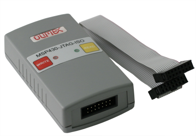

Optoisolated professional USB JTAG Olimex MSP430-JTAG-ISO
MSP430-JTAG-ISO optoisolated professional USB JTAG for mass programming and flash emulation.
Detailed Description
FEATURES:
  • program all MSP430Fxxx flash microcontrollers
  • ultra fast programming 13KB/s faster several times than TI-USB-FET (1.3KB when spy-bi-wire)
  • uses TI standard 2×7 pin JTAG connector
  • Spy-Bi-Wire support for the newest TI MSP430 devices
  • Can burn the MSP430 JTAG security fuse
  • optoisolation 1000VDC, target circuit can be high voltage powered (electricity meters safe debugging)
  • can supply target with variable voltage
  • internal Flash - can work stand alone (with external power supply +12VDC)
  • can work without computer in-field for firmware upgrade
  • MSP430.dll makes it compatible with all existing software which works with TI-USB-FET (emulates TI-USB-FET)
  • compatible with IAR Kickstart software for programming, real time emulation, debugging, step by step program execution, breakpoints, memory dump etc everything all high priced emulators do
  • with IAR Kickstart you can write in assembler unlimited code size and to write in C with 2K limit for all MSP430 microcontrollers
  • works with free GCC C compiler and Insight MSP430 toolchain and debugger
  • for MAC-OS users: reported to work with PS X 10.4 and current Parallels
  • dimensions 90×50×20 mm (3.5×2×0.8") + 20 cm (8") cable
