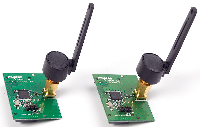

Evaluation Kit Texas Instruments CC2420EMK
This evaluation kit includes two CC2420EM modules and antennas.
Detailed Description
The CC2420EM are add-on daughter boards that require a CC2420DK or CC2420DBK development kit for evaluation and development.
The CC2420 is a true single-chip 2.4 GHz 802.15.4 compliant RF transceiver designed for low-power and low-voltage wireless applications. The CC2420EMK evaluation kit in combination with a CC2420 development kit is a powerful and flexible tool specifically designed to make it easy for the user to evaluate the RF performance of the CC2420 and to minimize the time spent on evaluation.
Texas Instruments: CC2420EMK Evaluation Kit
Features
  • True single-chip 2.4 GHz IEEE 802.15.4 compliant RF transceiver with baseband modem and MAC support
  • DSSS baseband modem with 2 MChips/s and 250 kbps effective data rate
  • Suitable for both RFD and FFD operation
  • Low current consumption (RX: 18.8 mA, TX: 17.4 mA)
  • Low supply voltage (2.1 – 3.6 V) with integrated voltage regulator
  • Low supply voltage (1.6 – 2.0 V) with external voltage regulator
  • Programmable output power
  • No external RF switch / filter needed
  • I/Q low-IF receiver
  • I/Q direct upconversion transmitter
  • Very few external components
  • 128(RX) + 128(TX) byte data buffering
  • Digital RSSI / LQI support
  • Hardware MAC encryption (AES-128)
  • Battery monitor
  • QLP-48 package, 7×7 mm
  • Complies with ETSI EN 300 328, EN 300 440 class 2, FCC CFR-47 part 15 and ARIB STD-T66
  • Powerful and flexible development tools available
  • applications
    • 2.4 GHz IEEE 802.15.4 systems
A complete Evaluation Kit includes:
  • 2 CC2420 evaluation modules which contain:
    • CC2420 chip
    • Required external components
  • 2 Antennas
