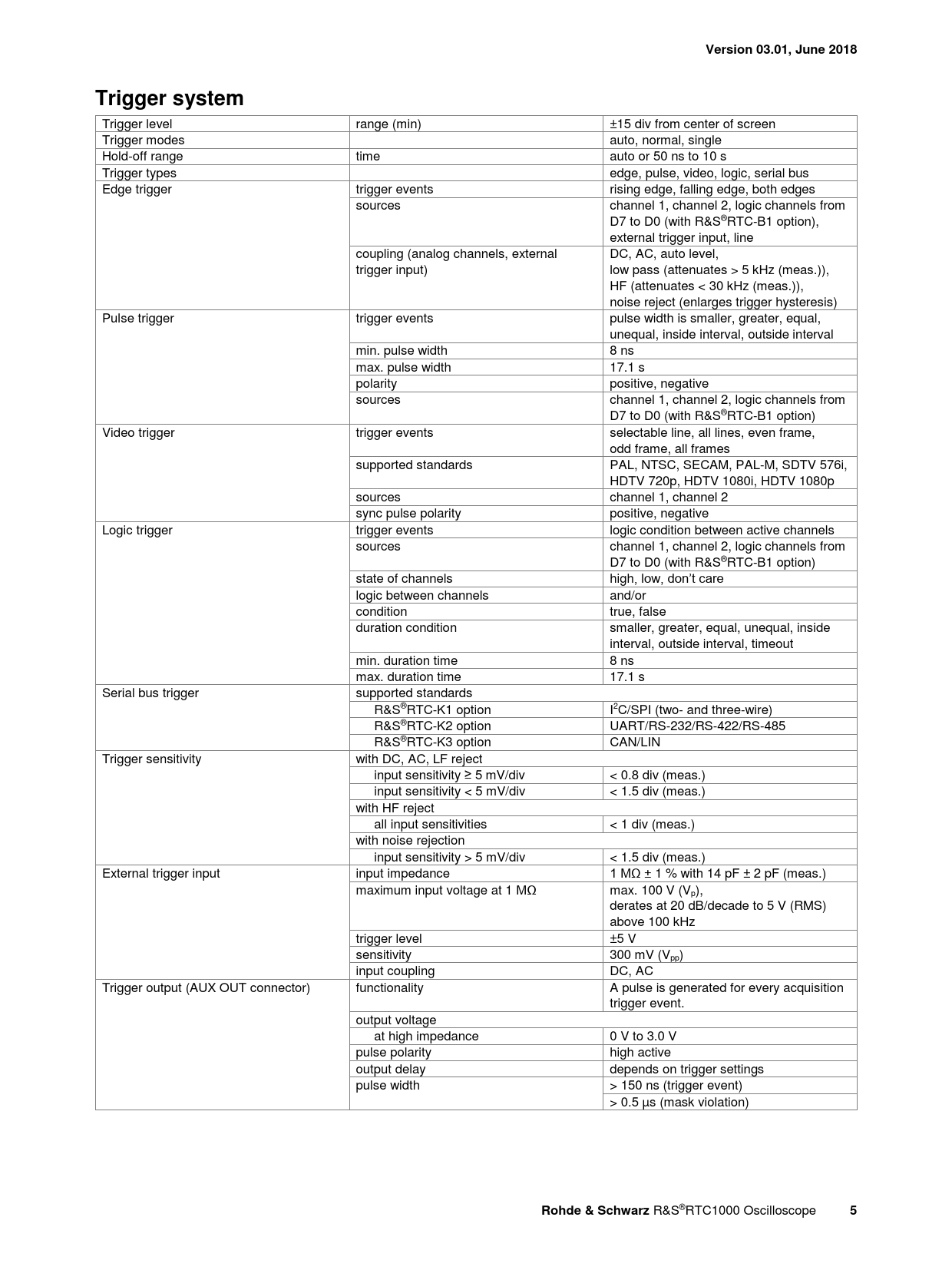

Version 03.01, June 2018. Trigger system. Rohde & Schwarz
Version 03.01, June 2018 Trigger system Rohde & Schwarz
Trigger level range (min) ±15 div from center of screen Trigger modes auto, normal, single Hold-off range time auto or 50 ns to 10 s Trigger types edge, pulse, video, logic, serial bus Edge trigger trigger events rising edge, falling edge, both edges sources channel 1, channel 2, logic channels from D7 to D0 (with R&S®RTC-B1 option), external trigger input, line coupling (analog channels, external DC, AC, auto level, trigger input) low pass (attenuates > 5 kHz (meas.)), HF (attenuates < 30 kHz (meas.)), noise reject (enlarges trigger hysteresis) Pulse trigger trigger events pulse width is smaller, greater, equal, unequal, inside interval, outside interval min. pulse width 8 ns max. pulse width 17.1 s polarity positive, negative sources channel 1, channel 2, logic channels from D7 to D0 (with R&S®RTC-B1 option) Video trigger trigger events selectable line, all lines, even frame, odd frame, all frames supported standards PAL, NTSC, SECAM, PAL-M, SDTV 576i, HDTV 720p, HDTV 1080i, HDTV 1080p sources channel 1, channel 2 sync pulse polarity positive, negative Logic trigger trigger events logic condition between active channels sources channel 1, channel 2, logic channels from D7 to D0 (with R&S®RTC-B1 option) state of channels high, low, don’t care logic between channels and/or condition true, false duration condition smaller, greater, equal, unequal, inside interval, outside interval, timeout min. duration time 8 ns max. duration time 17.1 s Serial bus trigger supported standards R&S®RTC-K1 option I2C/SPI (two- and three-wire) R&S®RTC-K2 option UART/RS-232/RS-422/RS-485 R&S®RTC-K3 option CAN/LIN Trigger sensitivity with DC, AC, LF reject input sensitivity ≥ 5 mV/div < 0.8 div (meas.) input sensitivity < 5 mV/div < 1.5 div (meas.) with HF reject all input sensitivities < 1 div (meas.) with noise rejection input sensitivity > 5 mV/div < 1.5 div (meas.) External trigger input input impedance 1 MΩ ± 1 % with 14 pF ± 2 pF (meas.) maximum input voltage at 1 MΩ max. 100 V (Vp), derates at 20 dB/decade to 5 V (RMS) above 100 kHz trigger level ±5 V sensitivity 300 mV (Vpp) input coupling DC, AC Trigger output (AUX OUT connector) functionality A pulse is generated for every acquisition trigger event. output voltage at high impedance 0 V to 3.0 V pulse polarity high active output delay depends on trigger settings pulse width > 150 ns (trigger event) > 0.5 µs (mask violation)
