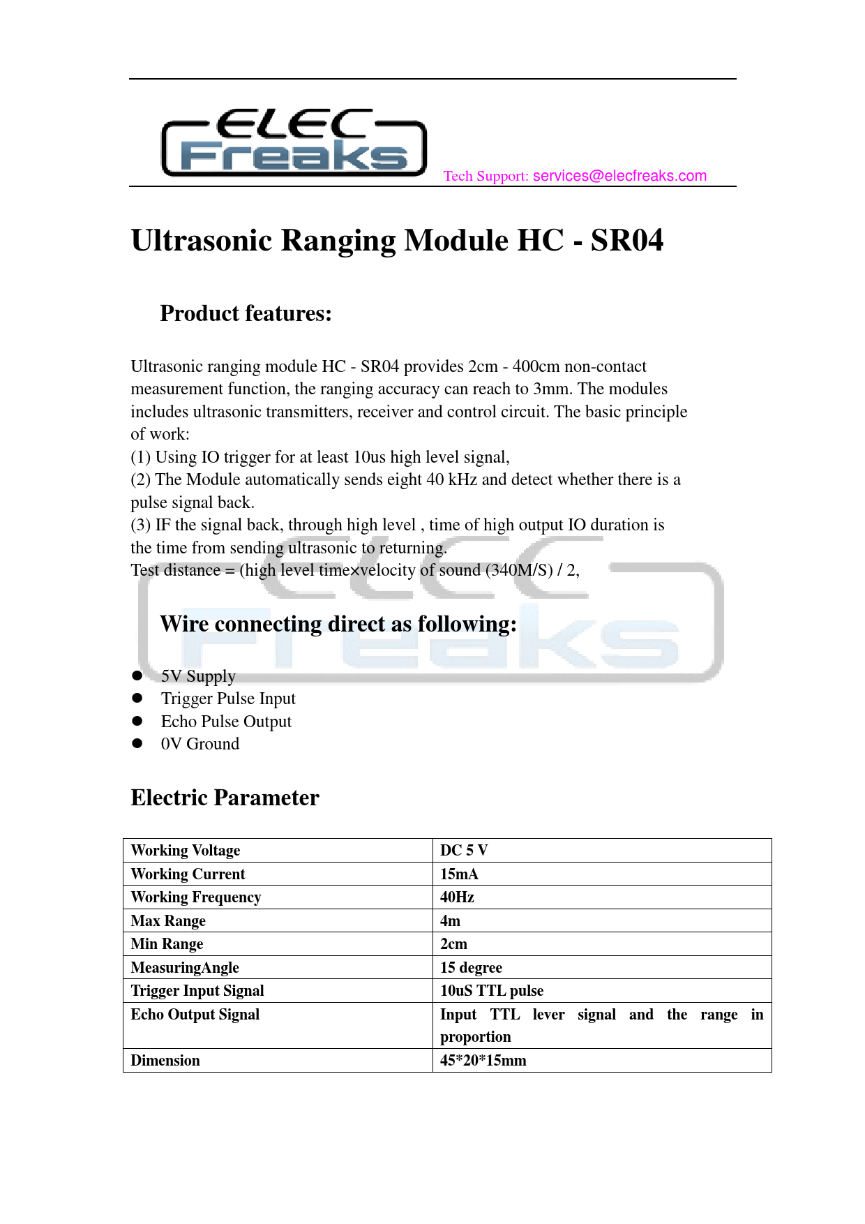

Ultrasonic Ranging Module HC - SR04 Product features:
Ultrasonic ranging module HC - SR04 provides 2cm - 400cm non-contact measurement function, the ranging accuracy can reach to 3mm. The modules includes ultrasonic transmitters, receiver and control circuit. The basic principle of work: (1) Using IO trigger for at least 10us high level signal, (2) The Module automatically sends eight 40 kHz and detect whether there is a pulse signal back. (3) IF the signal back, through high level , time of high output IO duration is the time from sending ultrasonic to returning. Test distance = (high level time×velocity of sound (340M/S) / 2,
Wire connecting direct as following:
5V Supply Trigger Pulse Input Echo Pulse Output 0V Ground
Electric Parameter Working Voltage DC 5 V Working Current 15mA Working Frequency 40Hz Max Range 4m Min Range 2cm MeasuringAngle 15 degree Trigger Input Signal 10uS TTL pulse Echo Output Signal Input TTL lever signal and the range in proportion Dimension 45*20*15mm
