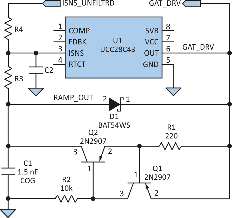

The circuit in Figure 1, however, generates a ramp whose slope is independent of the input voltage. It does so by charging a capacitor with a constant-current source using the control IC’s (U1’s) PWM gate drive (pin 6, OUT) as an input.
Adding a simple constant-current-source, gate-driven ramp generator for slope compensation improves the stability and accuracy of a switch-mode power supply.
Figure 1. Adding a simple constant-current-source, gate-driven ramp generator
mode power supply.

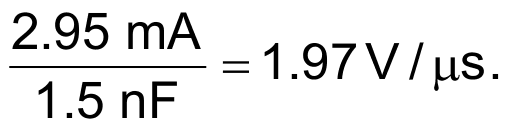

Suppose that the input voltage to the SMPS (pin 7 on U1, whose connection has been omitted for clarity), is at the 9-V minimum. When the pulse is high, at around 7.5 to 8.0 V, the network R1-Q1-Q2-R2 forms a constant-current source that feeds capacitor C1. For R1 = 220 Ω (and VBE = 0.65 V), the current is about 2.95 mA. When fed into C1 for a time t, this constant current produces a ramp voltage across C1 in accordance with the equation:
or
and the slope of the ramp is:
So for the example circuit, the slope is
For a switching period of 3.0 µs (333 kHz) and a duty factor of 2/3, the on-time of the PWM pulse is 2.0 µs. Therefore, the slope-compensating ramp’s peak is 3.94 V.
When the pulse goes low, diode D1 conducts and discharges C1 to near 0 V. R1 and C1 must be chosen so the ramp’s peak voltage doesn’t equal or exceed the minimum input voltage, which is 9.0 V in this case. Also, R3 and C1 must be chosen so R3 doesn’t load down C1.

When the input is at its maximum, 16.0 V, the ramp slope is still 1.97 V/µs, which would not be the case when using an R-C network. The ramp is inputted to resistor R3, and the sensed current waveform, ISNS_UNFLTRD, is inputted to R4. The sum of the two appears at U1 pin 3, which is the control IC’s current-sense input. The measured waveform showed no change when varying the input from 9 to 16 V (Fig. 2).
