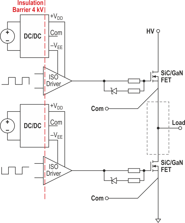

In applications using SiC/GaN high-voltage semiconductor devices under hard-switching operation, galvanic isolation is a common requirement for safety and functional reasons, and depending on the application, a basic or a reinforced insulation will be required. The operating voltage, insulation material, pollution degree and the applicable regulatory standards set the minimum creepage and clearance distances as well as the dielectric isolation voltage requirement affecting the components placed across the isolation barrier. The high-speed isolated gate driver IC (e.g. TI UCC21520) and the transformer in the isolated auxiliary power supply (DC/DC Block in figure 1) both ‘bridge’ this isolation barrier, thus having to meet stringent safety and functional requirements.
Overview of a HV half-bridge control of the High-side & Low-side SiC-MOSFET.
Figure 1: Overview of a HV half-bridge control of the High-side & Low-side
SiC-MOSFET.

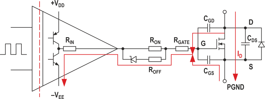

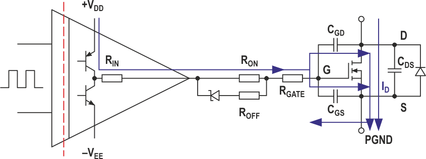

The latest SiC MOSFETs require gate-source voltages between +15 V and +20 V to fully turn on and between 0 V and –5 V to reliably turn off. For the gate of a gallium nitride FET (GaN 650 V) usually only +5 V and 0 V are required. In some cases, a small negative voltage is also used to turn off the GaN FET. Please note that these values vary depending on manufacturer. In figure 1, a half-bridge configuration is shown, and several of these stages are typically required in an inverter circuit to drive AC-motors in the kW range. Each SiC/GaN FET would require an independent gate driver stage with its own isolated auxiliary supply. This not only enables individual control of each SiC/GaN device, but also helps to keep the gate current loop small and local to the device, minimizing the adverse effects of parasitic loop inductance and ground bounce caused by the very high ΔI/Δt generated during the switching transition (figure 2 and figure 3).
High ΔI/Δt current paths on turn-ON of SiC/GaN FET.
Figure 2: High ΔI/Δt current paths on turn-ON of SiC/GaN FET.
High ΔI/Δt current paths on turn-OFF of SiC/GaN FET.
Figure 3: High ΔI/Δt current paths on turn-OFF of SiC/GaN FET.
If ignored, this may lead to uncontrolled turn-on/off of the MOSFET and thermal issues. Some SiC MOSFETs are designed with an additional low impedance Kelvin source connection for a gate current return path (figure 4).
