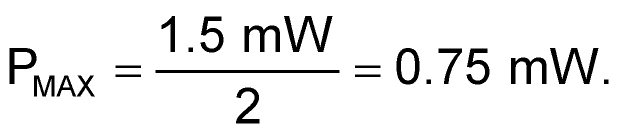

Or is it? What about that dissipation (self-heating) factor (1.5 mW/°C)?
We obviously don’t want thermistor self-heating to significantly interfere with the temperature measurement. A reasonable limit for self-heating error might be half a degree and in the case of the 2152723803’s 1.5 mW/°C, this would dictate limiting maximum dissipation to no more than:

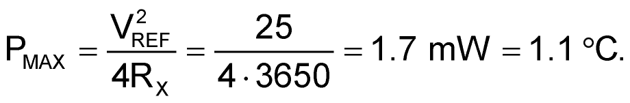

Dissipation maxes out to
when RT = RX and in this case of VREF = 5 V will therefore be:

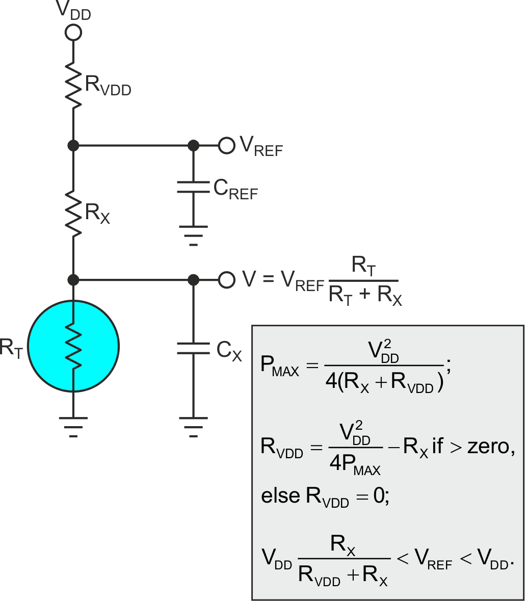

Yikes! That’s more than twice the stipulated maximum self-heating error. What to do? Not to worry, a solution is suggested by Figure 2.
RVDD limits max thermistor self-heating to PMAX.
Figure 2. RVDD limits max thermistor self-heating to PMAX.
Dipping again into the 2152723605 numbers and keeping VDD = 5 V:
RVDD = 8333 – 3650 = 4.7k,
PMAX = 0.749 mW,
2.8 V < VREF < 5 V.
Note that if the Figure 2 math yields a zero or negative value for RVDD, then no RVDD is required, and the original Figure 1 circuit will work just fine.
Although VREF will vary with RT and therefore temperature, external-reference monolithic ADCs are typically very tolerant of VREF variations within the range shown and will perform accurate ratiometric conversions despite them.
