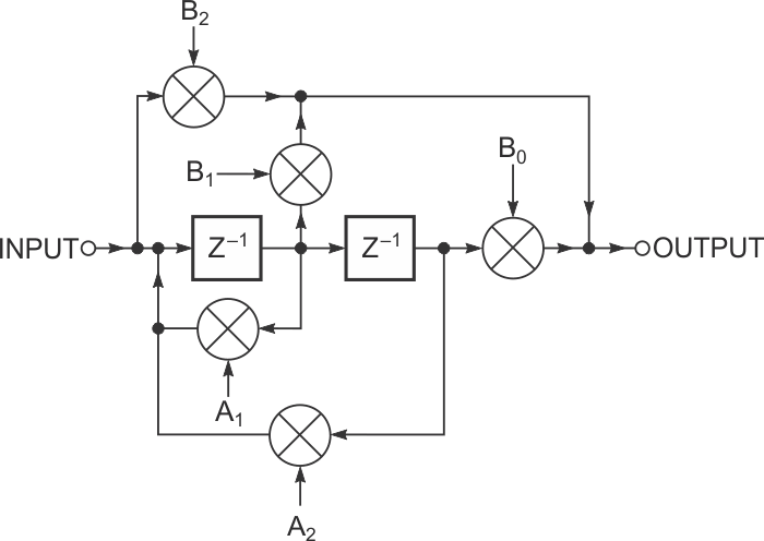

The transfer function for a second-order recursive digital filter has coefficient values that yield a lowpass, highpass, band-reject, or bandpass-transfer function.
Figure 1. The transfer function for a second-order recursive digital filter has
For example, Figure 1 shows a second-order recursive digital filter. The transfer function for this filter is:
where H(z) is the digital-filter-transfer function, z is the z-transform variable, the AS are the coefficients of the denominator polynomial of the transfer function, and the BS are the coefficients of the numerator polynomial of the transfer function. You can obtain the coefficient values with software available for filter design (Reference 1). The sampling frequency, fS, relates to the transmission-line delay as t = 1/fS. For example, a bandpass digital filter with a 3-dB passband from 900 Hz to 1 kHz, a sampling frequency of 6 kHz, and a Butterworth characteristic yields the following transfer function:

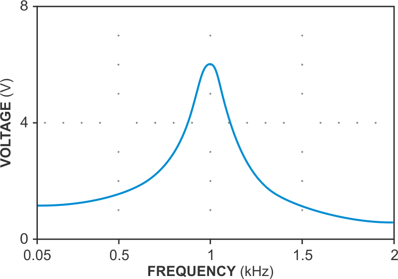

In this case, the transmission-line delay is 1/6000 = 166.67 µsec. If you additionally specify an impedance, Z, of 1 Ω for the transmission line, then the parameters for the transmission line are Z0 = 1 Ω, and t = 166.67 µsec. Figure 2 shows the PSpice circuit. The VCVSs (voltage-controlled voltage sources), E1 and E2, simulate voltage followers, and VCVSs E3 and E4 and the resistors that connect to them simulate summers. Figure 3 shows the results of the simulation.
In this PSpice simulation, the digital bandpass filter uses transmission lines as delay lines.
Figure 3. In this PSpice simulation, the digital bandpass filter uses transmission
