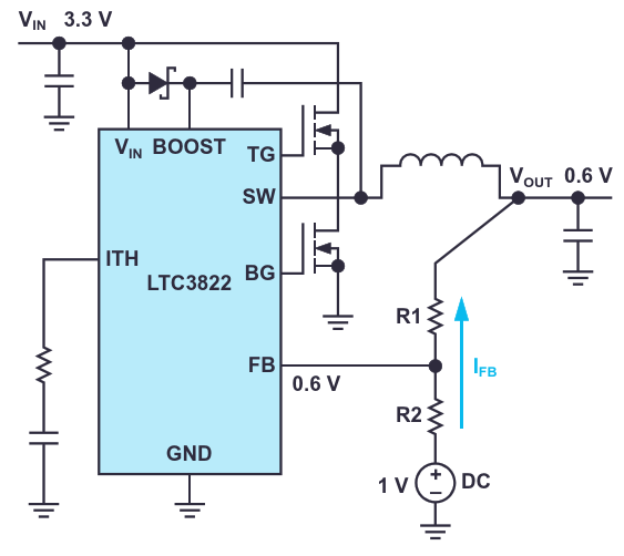

Generate Sub-1-Volt Rails Using Standard Regulators

Figure 1. An LTC3822 dc-dc converter can be used to generate low output voltages down to 0.6 V
Figure 2. The circuit is modified to generate output voltages of less than 0.6 V
Figure 3. A simulation tool such as LTspice from Analog Devices can be used for initial testing of the circuit to verify that the configuration will work with these components (in principle)
