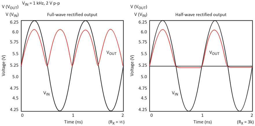

Figure 1. By taking advantage of a saturated bipolar transistor's "gain reversal" phenomenon, this circuit can perform full-wave signal rectification using only one transistor
Figure 2. A full-wave rectifier is realized by setting R
X
= ∞. Half-wave rectification is predicted at R
X
= 3k
Figure 3. Measured waveforms verify the full-wave (a) and half-wave (b) performance predicted by the Spice analysis
