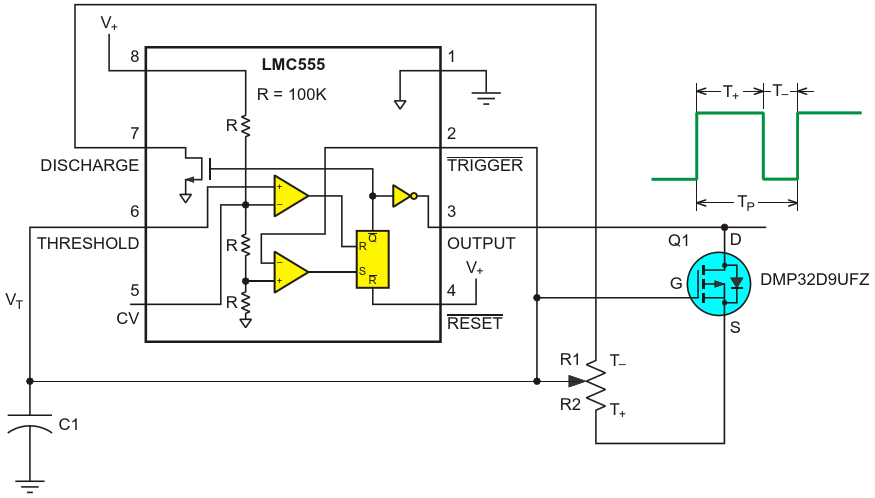

An inverted polarity MOSFET Q1 restores timer precision
Stephen Woodward
Inverted MOSFET helps 555 oscillator ignore power supply and temp variations
Figure 2
21 Kb
Figure 1. Diode D1 causes temperature dependence in this 555 timer circuit
Figure 2. An inverted polarity MOSFET Q1 restores timer precision
