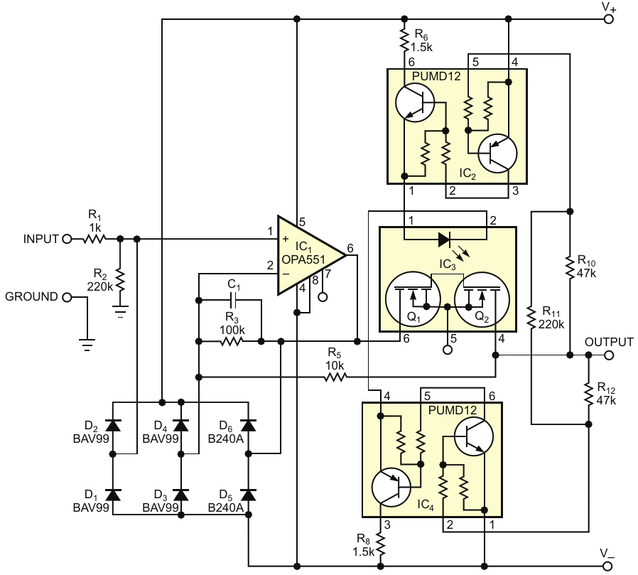

This circuit requires only …
This circuit requires only a couple of external components to use an SSR for output-overvoltage protection

Figure 3. This series-protection circuit disconnects the amplifier-output terminal using a series-connected, high-voltage SSR
Figure 4. This circuit requires only a couple of external components to use an SSR for output-overvoltage protection
