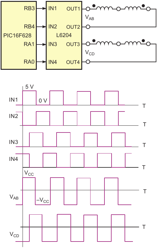

Waveforms show how each …
Waveforms show how each coil is excited
F Ferrero, J Blanco, JC Campo, M Valledor
Electronically generate rotating magnetic fields
Figure 3
12 Kb
Figure 1. Two pairs of magnetic coils and their excitation waveforms show how to generate a rotating magnetic field
Figure 2. The circuit comprises a full-bridge driver and a microcontroller
Figure 3. Waveforms show how each coil is excited
